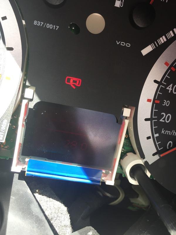

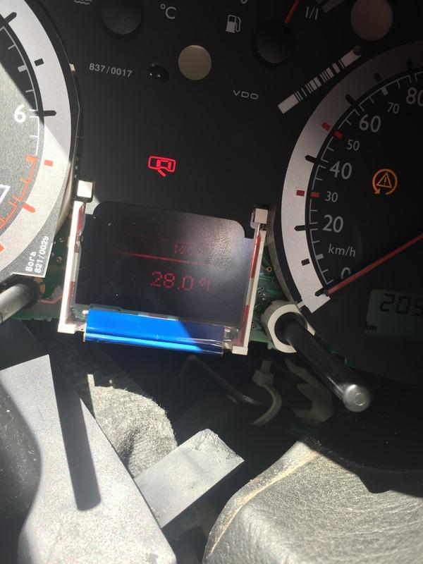

            I do know that all lcds have a contrast setting, seeing as how it's only dull, I had a look online to see if anyone had the same idea, there was, I followed most of his advise, however I will be using a different resister to him, this is how it has turned out so far, you can see it without the resister, almost can't see anything, with it much better, once I get the right one, it should be sweet.

                So far not much luck with the resisters I have on hand (they are quite close together in ohms), going to buy a Potentiometer tomorrow and install a variable contrast dial for it, that way I can set it to what I want.

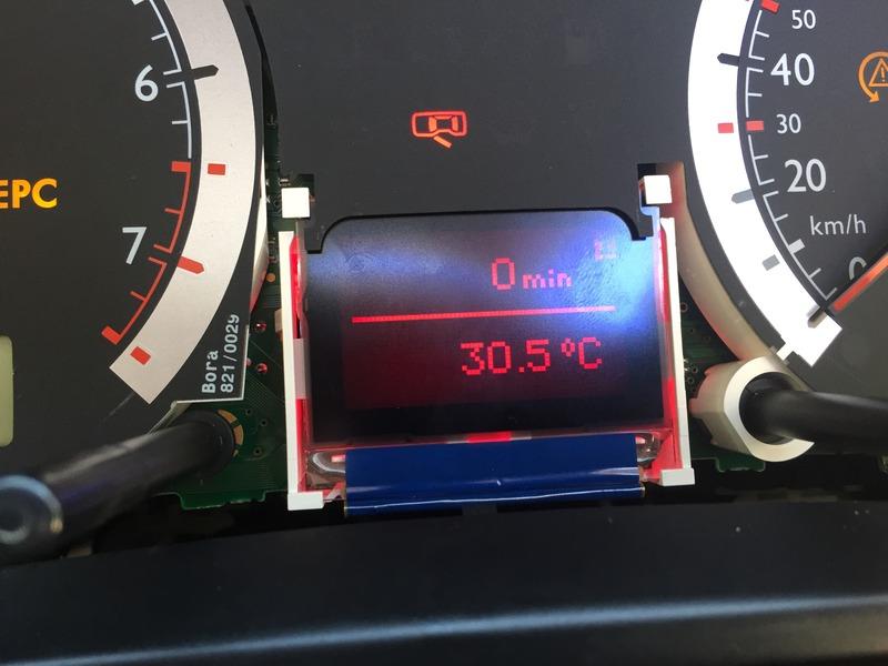

                  So I ended up running with a pot to have a variable contrast, of course I picked up the wrong one so I had to customise it with some additional resisters, which ended up being about 100k of resistance. Depending on how bad your screen is will depend on how much you will require to put inline.

                      Yeah, mine is fine during the night and when the inside is at low temps, however the qld heat seas to it that the inside of my car is never below anything reasonable, all those photos and videos are of well over 30deg, car was sitting in direct heat closed up, trust me it was well and truely 40+ deg in the cabin.
                      To explain a bit more about how this works, lcds have variable contrast, which in basic sense creates different viewing angles as it changes the frequency of the panel, by increasing the contrast you change the viewing angle (and it's brightness ) thus 'repairing' the LCD. Why it changes in higher temps? It's basically the two pieces of glass with the element in the middle of them expanding, which changes the contrast of the screen, as it makes it harder for the LCD to produce its lines. This generally starts on the outside and works it way in. Anywho's, it cost me about $8 because I bought a few different pots and resisters. However it should cost most people about $3.50 and about an hour. Medium soldering skills are required.
