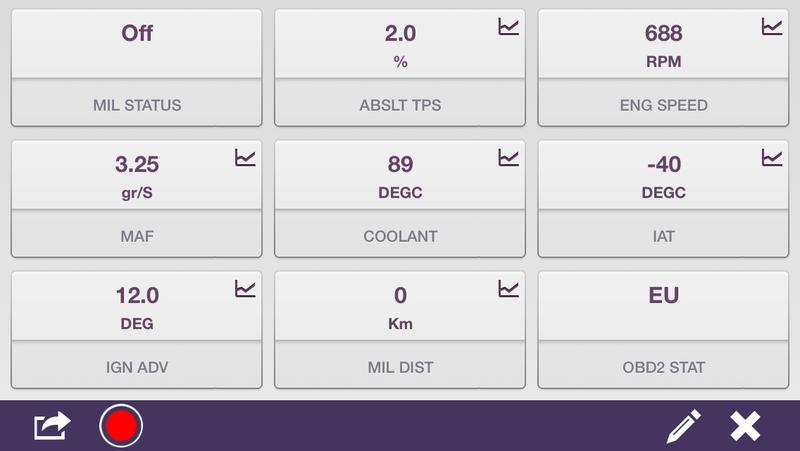

So I took some readings off the scan tool, unsure if this helps or not, I read somewhere about the timing adjust shouldn't be anymore than 9deg at idle, however I am not quite sure as it jumps around a bit, goes from 5 to about 15 at some stages all at idle no load no ac on
Also as you can see my intake air temp is still erroring, fixing the pcv valve pipe made no difference
