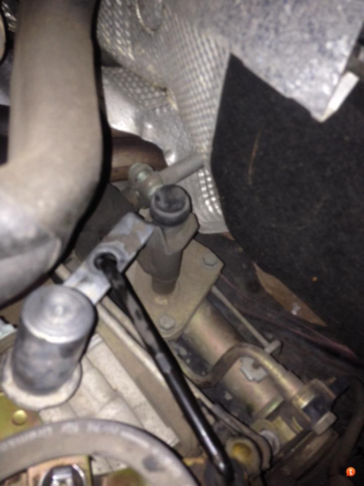

    Hey gus, my bushings are gone and i get clinks when ever i shift gears and im ordering new bushings and im confused as to what type of shifter style i have is it the, pin style endlink & shifter linkage ball/socket style linkages.
    can anyone sort me out i have a 2004 mk4 golf generation 1.6lVW Shifter Bushing Set - Mk4 5/6S MY02-05

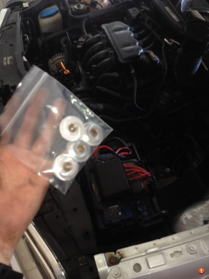

    Bump. looking at getting these Torque Solution Shifter Cable Bushings VW Golf VR6 MK4 1999 99 | eBay

      Get the 42DD ones from Carformance (local Aussie distributor for 42DD)

          ordered the 42dd this morning! hopefully they get the job done!

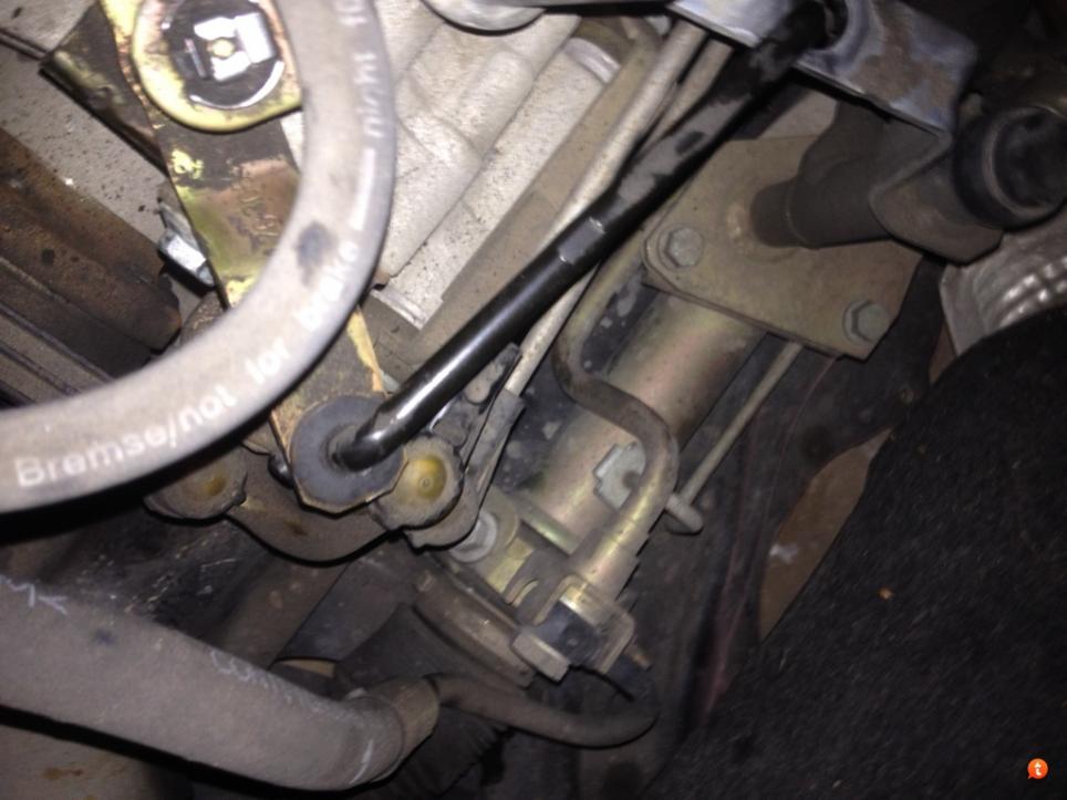

            So i found out what the clinking noise was the bushings are gone on the rod so these bushings i got dont really help me that much except for a tighter shifter. But i have no clue where they go onall the youtube tutorials are crap!! Someone help me out!
            achat sildenafil mylan prezzo
              The bushings you have gotten appear to be the ones that mount the shift lever up into the trans tunnel.

                hmmm do you know what the bushing i need is called its the one that goes on that black rod

                  forgot about this, went to repco and bought a $5 pair of bushings and theyve done the job!
