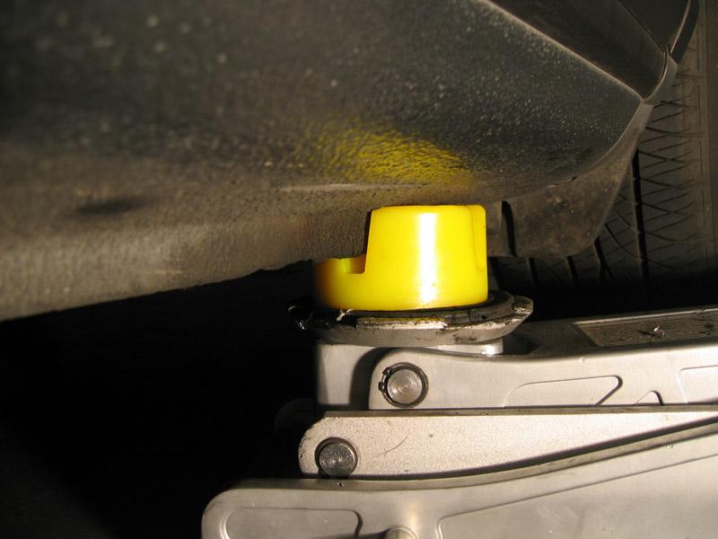

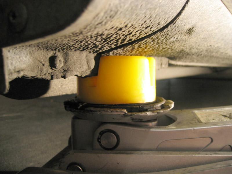

        You can just buy one of these for your floor jack and then you can jack it on the pinch rail properly
        Pure Motorsports is where I bought one for myself and Graeme.
        Alternately buy an ice hockey puck and use a table saw to cut a groove into it and use that.
        Cheers Al
        thanks for that, but what is the contact point supposed to be?
        from looking at the widow maker, it seemed to seat most of the weight on the inside of the rail, i.e a flat part of the sill(?) that you can't see, as i couldn't see any marks left on the widow maker where the rail would have sat.
        in this post, it looks like no weight is put on the rail, yet the person doesn't think it is correct.
        and as i said, i initially put my widow maker in the wrong position, and so that it was lifting up on the outside flat part of the sill (outside as in the side closest to you that you can see), and it deformed it by 10mm+, so def not strong enough there!
        (as yes i used the correct 13cm and 22mm distances or whatever they are as the book says. I noticed are actually dents that indicate these points on my car, doesn't look very clean... this on all cars?

          You said you used a floor jack after the widow maker, I was showing you a part you can use with a FLOOR JACK so as to not damage the pinch rail. As you can see the pinch rail fits in the slot, all the weight is taken by the area that is supposed to take it.
            yep cheers, just wanted to confirm that because the person who posted in that link disagreed, and secondly, i found out today that it's not very strong on the outside of the pinch rail as my wrongly placed widow maker caused a decent depression there.
            i believe it's much stronger on the inside, i.e behind the pinch rail, rather than the outside, i.e towards the skirting, but that's just from what i observed today.
            and that makes sense as to why the widow maker is designed the way it is, it only puts the weight on the inside, unlike that yellow jack pad which looks like it supports on either side of the pinch rail.
            so the way i see it, when using a floor jack, it's ok to use a block of wood and place it just behind the pinch rail. anyone disagree with that?

                  Hey mate, where did you get the yellow mounting point insert for that jack?

                      One page back.
