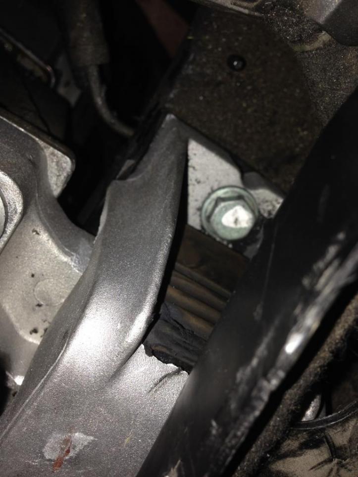

                      • ^that is nasty! Have you checked the prv valve (hockey puck) to see if that may have failed internally and a piece got sucked in? Continuing on with carnage pics, is discovered I need new engine mounts today

                            These were the 034 ones, I'll be ordering VF ones next. The PRV valve is the plastic round thing plugged into your tip next to the dv. It's part of the pcv system
                            • Originally posted by Lito View Post
                              Oh lawd...i would have thought the 034 mounts would have lasted.
                              I'll check the prv on my car, even thou I'm pretty sure Jmac would have been all over it if it was damaged.
