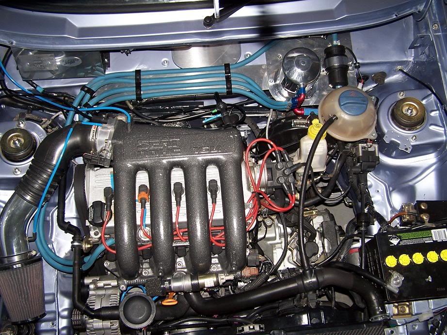

                                Your motor is a Digifant 3.1 - pre '96, no immobiliser, which is why it started up
                                High idle is a "limp-home" feature according to the VW ABF workshop manual. I s'pose the ECU winds up the idle as it must be unstable at 850rpm (vaccuum leaks probably cause this...).
                                The running rich problem could almost anything You're best to connect up all the sensors and wipe the fault codes and then see which codes come back up and also whether the motor still overfuels.
                                Chances are it's just very grumpy because it's missing a few things - so probably not a big deal.

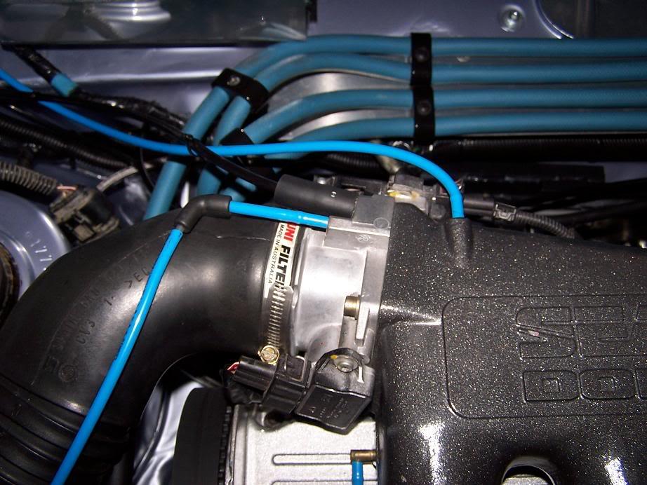

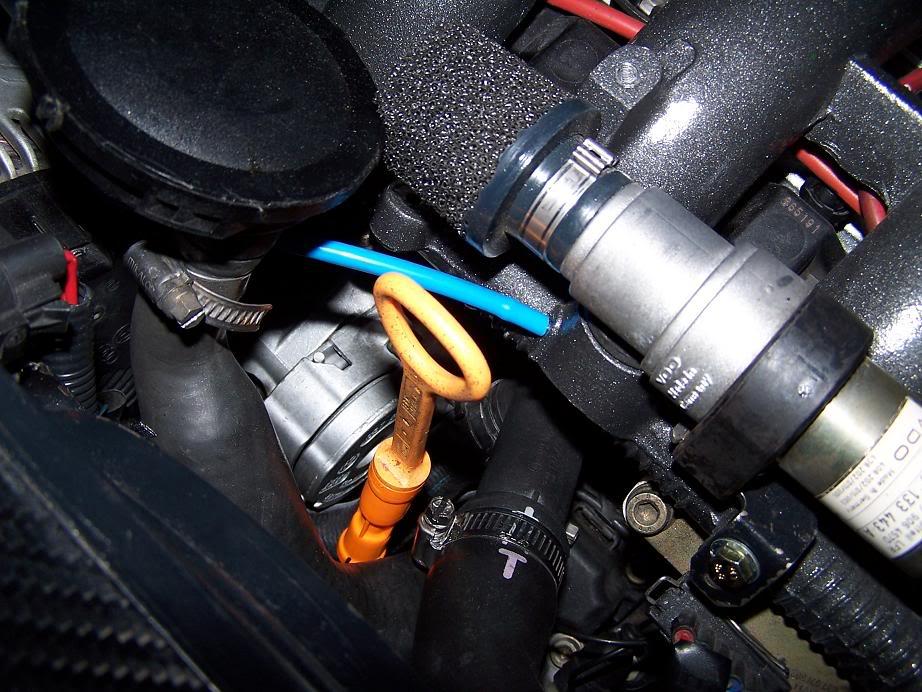

                                Next up, check your vaccuum line setups against mine...
                                Just went out and took as many pics as I thought would be useful to you. Sing out if you need more...
                                THIS MIGHT HELP YOU WITH OVERALL REFERENCE OF THE ENGINE BAY. REMEMBER THERE MAY BE A FEW DIFFERENCES BETWEEN THE 3.1 AND 3.2 ENGINES:
                                MY THROTTLE BODY IS THE DIGI 3.2 VERSION SO MAY BE A BIT DIFFERENT:
                                THE BREATHER SETUP ALSO HAS A VACCUUM LINE FROM BENEATH THE IDLE STAB'N VALVE - SEE WHERE IT RUNS FROM THERE TO THE BREATHER TRANSFER:
