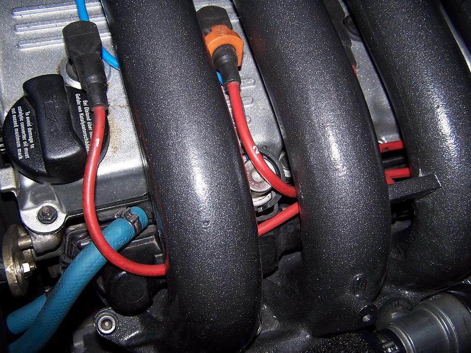

    YOU CAN JUST SEE THE FPR BREATHER HERE:

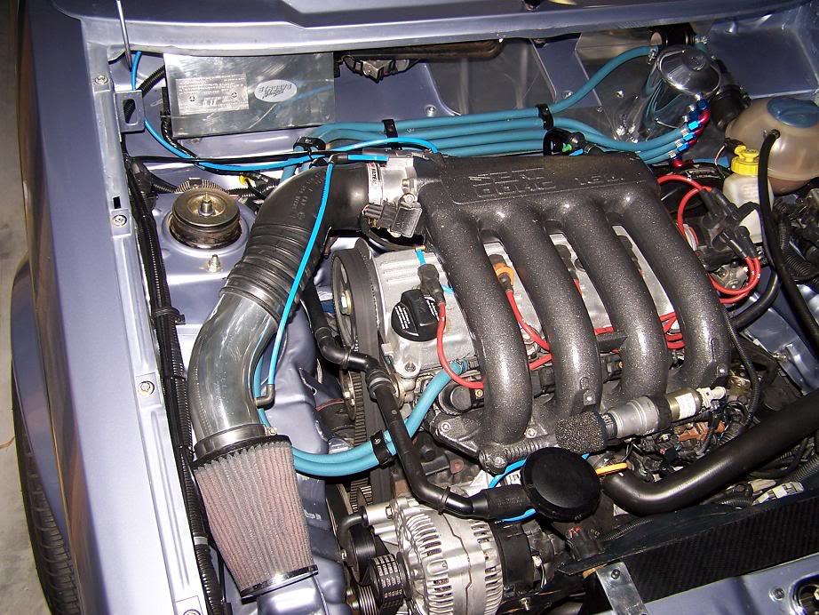

      THE BLACK OUTLET FROM THE T/B HERE RUNS TO THE CHARCOAL CANNISTER - THIS LINE IS VERY IMPORTANT AS THE ABF IS SENSITIVE TO EMMISIONS CONTROL... YOU NEED THE CHARCOAL SETUP AND IT MUST BE WIRED UP TO THE SENSOR (PIC OF SENSOR HERE TOO):
      CHARCOAL CANN. READER (JUST IN FRONT OF THE AIR FILETER). [B] IT HAS AN INLET LINE ON THE R/H SIDE - THE BLACK LINE FROM THE THROTTLE BODY - AND AN OUTLET, WHICH RUNS TO THE CHARCOAL CANNISTER ITSELF:

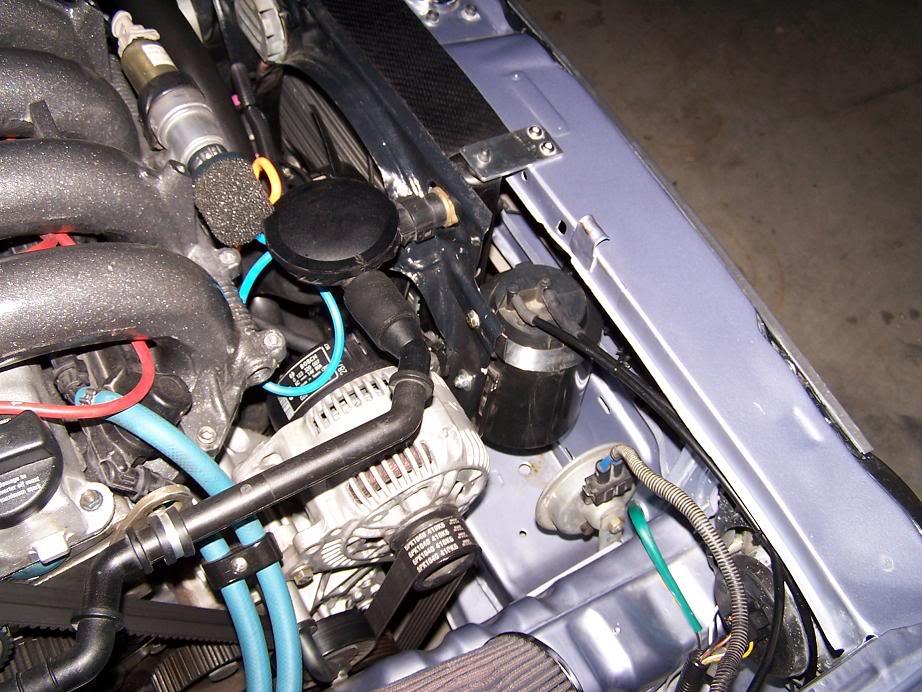

        THIS IS MY CHARCOAL SETUP - IT USES A WRX CATCHTANK AS THEY'RE A BIT SMALLER

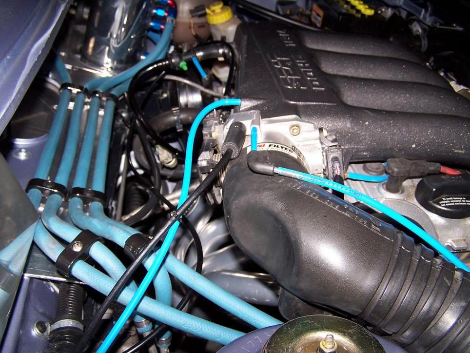

        THE ECU IS MOUNTED BEHIND THE VERTICAL ALLOY PLATE WITH THE STROEVE BADGE AND VIN ON IT. NOTE WHERE THE VACCUUM RUNS TO IT FROM THE INLET MANIFOLD:

            Last thing: the feed from the TB to intake pipe is the throttle closed breather - it needs to be air-tight otherwise the idle is a bit lumpy.
            I found this out by disconnecting it and testing what happened
            Ideally, it needs some small hose clamps on it (unlike my setup )

                This morning I have already driven to my grandma's, got the temp sensor, took a photo of what appears to be the vacuum line attachment on the ecu (didn't even know it was there), and drove to vw, paid $66.84 incl. GST for a new sensor, and now a two week wait out of germany...
                All done and home by 8.05am...
                pics for confirmation of ecu...
                (nice and crusty mind you, i think its sea salt related...)

                  The vacuum line thing will help you.
                  • #99
                    Yep, that's the vaccuum line. Plug that little fella in and see what happens. Tell VW to get with it and drop that sensor in an overnight bag!!!
