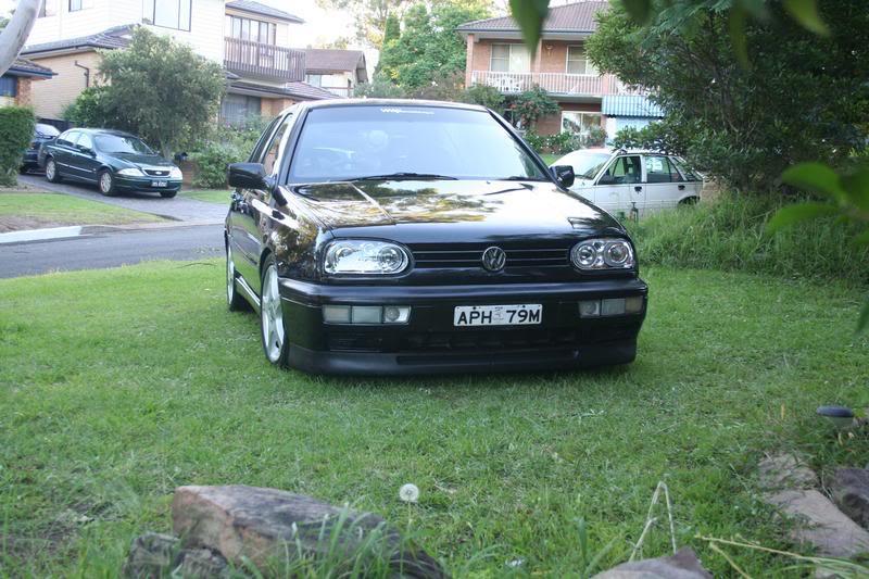

          This photo is the day the coils went in, after a little settling it was even lower...
          And one of my favourite shots:
          • mk3pete!!!!
            bloody freakin mother of all that is holy!!!! that looks so damn good!!!! How hard is it to adjust them yourself? I assume that is what the c spanner is for?

            • NICE! good to see it all worked out, pity you can't get the 16's on yet. Should look horn with them!
