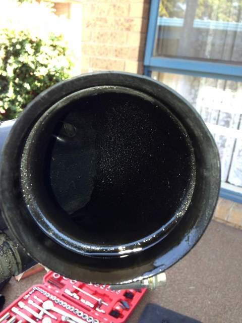

Is that video from cold start or with the engine warmed up? I have a similar noise to that when cold but goes when warmed up.
It's also normal that the idle is a bit higher when cold, approx 1000-1100 rpm, before dropping to around 680 rpm.
The Timing chain is located at the other end of the engine to where you were filming, wait until you've had new coil/leads installed, also ensure good clean oil before further investigation.
If you're really suspect on the chains, have the sump removed and check the contents for plastic when doing an oil change.
It may also be worth removing the rocker cover and checking for any slack on the chain (note you may want to have the cover gasket replaced at the same time)
