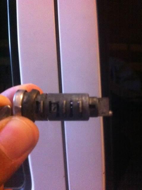

                              I also have another question, My drivers key barrel is stuffed and from what Ive been reading there is an eccentric that could just be replaced the get everything back up and running, but I dont know if that applies to me cause I can remove the whole key barrel from my door by just turning and pulling,I have attached a photo.
