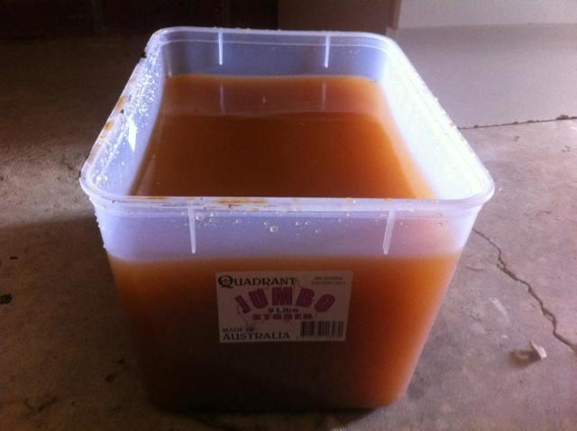

    Today I flushed the coolant because it looks like rust water
    It was all going well until I lost the drain plug in the engine bay, it's Lille the engine bay just swallowed it??? Has anyone got a spare that they wanna get rid off? Will I be able to get one from supercheapauto, really wanna get one ASAP to get back on the road.

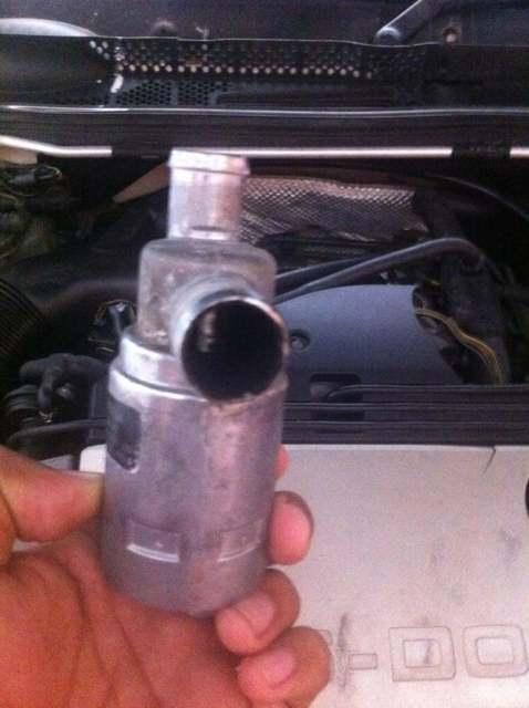

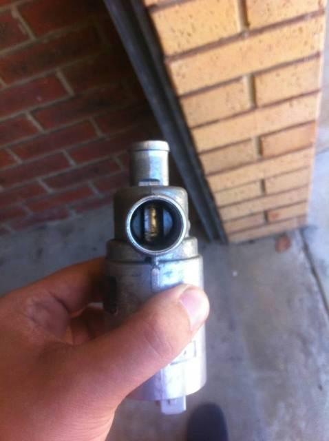

        Yesterday I finally had time to look more into this rough idle, loss of power and bucking. I was reading up online that I should look at cleaning the idle control value do here goes. I removed the value and had a look inside and it was pretty dirty (I'm new to going DIY, so please bare with me).
        I then cleaned it our using carb cleaner and it seemed to do the job

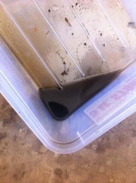

        And this is what came out
        After putting it back in I did notice a more steady idle and the bucking seems to have gone (touch wood) but we will have to see. Keeping in mind she is rolling on 200,000k's. I'm also currently looking for a good place to do a engine recon. Anyone got any ideas, experiences, good and bad and prices?
