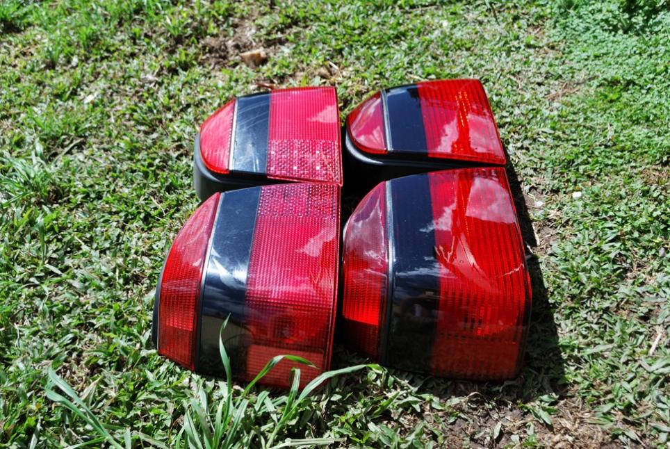

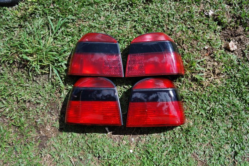

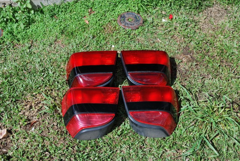

I picked up the rad support and tails from Ben (<-champ) after a polish so the front end is all back together and tails are replaced, check those off!

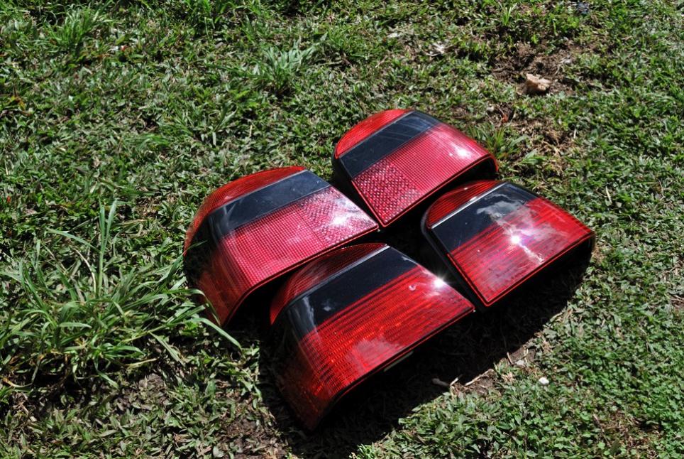

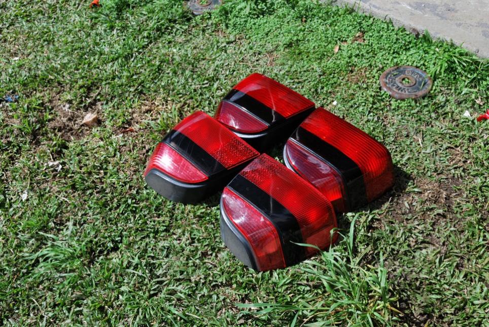

Also for those reading this thread, i'll sell my Hella All Reds to the highest bidder here, starting @99c. They're not perfect, they've had the inner amber lense removed from the indicators, chip in one (siliconed up), a crack on the top of the black plastic, a scratch down the side and i'll leave the tint strip on there so you can remove or use it at your will. should be able to see all that in the pics.....
The "new" tails were standard CL items, sanded smooth, all red tinted, black tinted center and 2k cleared. I belive they're much nicer looking than the hella items, more of a cherry red and super shiney!

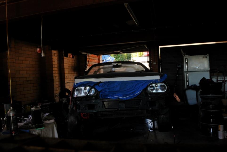

update time

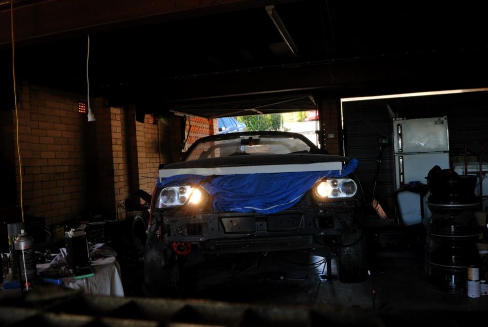

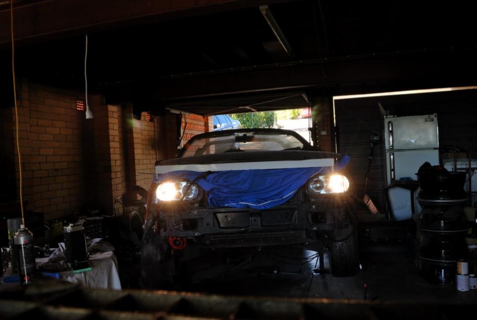

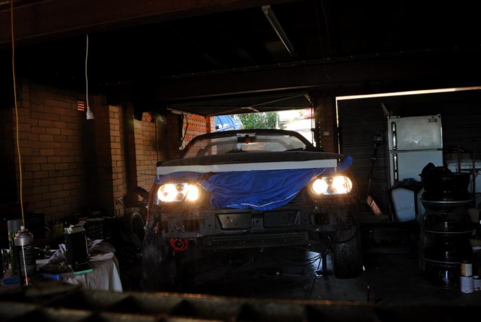

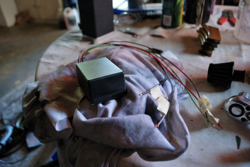

I bought a drl module from a german chap to allow me to run my main beams at a reduced rate (adjustable from 10%-90% but is set at 40% right now) just the same as all the newer euros
And all hooked up! Was super easy with the bentley schematics and i'm super happy with it
The Module
Off
Reduced High beams / DRL's (comes on with the ignition)

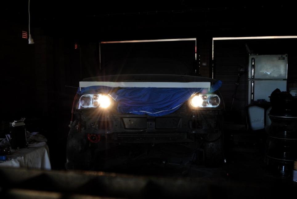

High Beam Flash (Full Power)
Low beams (DRL's turn off)
Low Beams + Full Power High Beams
Yeh for sure but you may as well just put your low beams on? :-P or hardware your low beams to the ignition so that your rear and interior doesn't light up....Originally posted by dylan8 View PostYeah ok, no real art to it then, just get it out however possible haha.
That drl module is awesome. Think it would work with lows on the vento?
