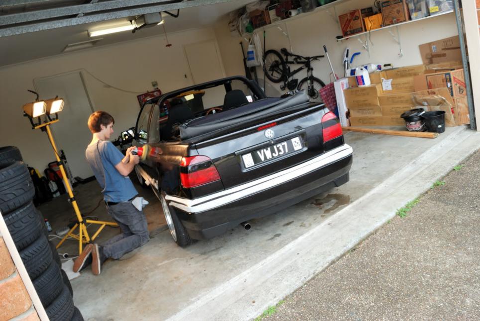

    So Ben (Ben J) came over today with three buckets of detailing products to throw at the cabrio today and since he spent nearly all day, I thought it was worth a post up to give him a shout out!
    I'll also use this thread to post up the little things I do to the cabrio instead of dumping in the pic whoring thread...

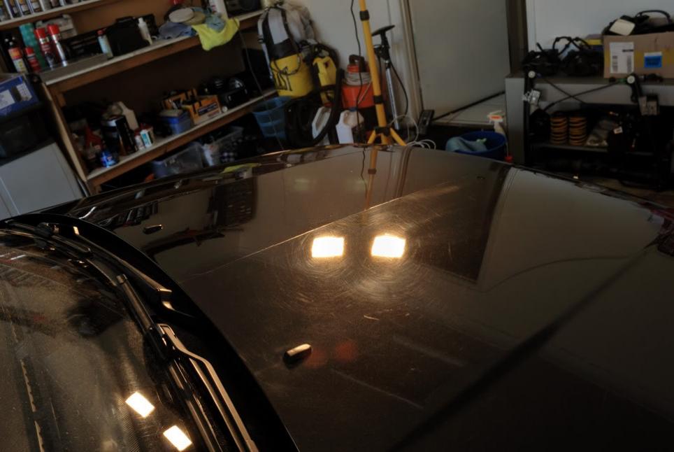

    So I knew it was bad....but not THAT bad under these lights it really showed..... just a few pics...
    and Ben on his knees like the good boy he is I think those lights were keeping him warm too, haha
    Thanks again dude, and cheers for letting me have a whirl with the equipment too!
    Garage looking like a studio. Great work Ben, get some shots in the sun 'L' 'X'.

      Good work Benny.
      What products did you use out of interest?
      It's scary how bad a car looks under the halogens.
      It's also scary how hot the halogens get, I'm usually drenched with sweat after working in front of them for hours.

          Glad I could help.
          If anyone in the brisbane area wants thier car done I'm happy to give it a go for a little money, am by no means a professional and my results probably do show that Still, hit me up if interested
          On this we clayed it with some dodo clay, and polished it with Menzerna Fast Gloss FG500 on a cutting pad, followed by Menzerna Power Finish PF2500 on a medium polishing pad, and finished off with the highest gloss Menzerna Polisish (forget its name) on a finishing pad. Hit it all with lime prime after that and then a coat of duragloss 601 + 105 sealant combo.

                    such a nice transformation!
                    It's amazing what a hard days work, the right tools/products (and some knowledge) can do!

                        Sounds good, a bit of a glaze to fill some of the scratches I couldn't get out could have been nice. I'll keep it in mind next time I'm buying products.
                        Alex's car is actually green, although a little hard to tell in photos haha. Still, the metallic definitely stands out a lot more than it did before, could barely tell when it was covered in swirls. I have a couple nice waxes hidden away somewhere which would have really made the metallic green pop but not sure where they are so just used the sealant, which still does a pretty nice job.

                          green?? you on drugs?? lmao..... or am I on drugs? haha
                          but alas, yes the metalic is popping like crazy now, I can't believe how much those swirls hid it! ......
