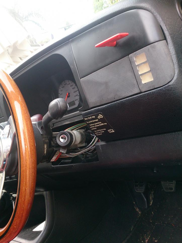

                  I refinished that killswitch blank panel properly, looks much better now and am happy with it...
                  Boring I know, but I bought a new roof; Apparently the roof that's on there was new when I bought it? either it wasn't or it was a **** china roof because the seam at the rear has opened up. Been like it for a little while and is slowly getting worse so i've ordered a new, german made, seamless, original cloth top. Just need to summon the motivation to get it on!

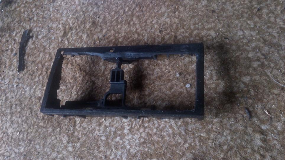

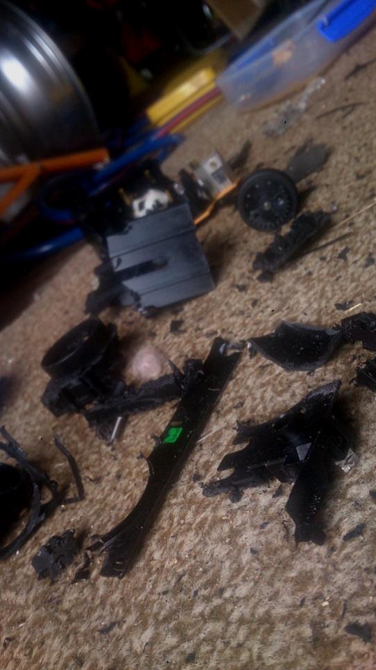

                  Getting silly with the shaving now, i've decided to shave the headlight switch, haha.... plans are to convert the headlights and ignition switch with some oem looking buttons, hopefully it pulls off.....the "finished" pics at the end are unpainted but you get the idea....
                  gutted light switch with the locking mechanism left

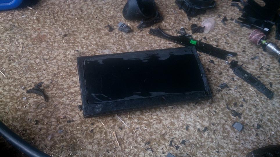

                  Made a blanking panel
                  welded and sanded

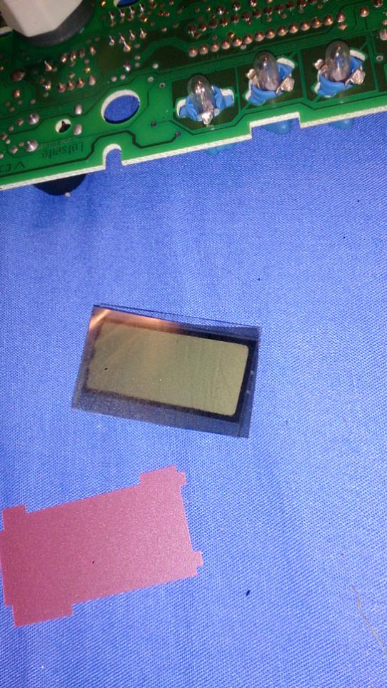

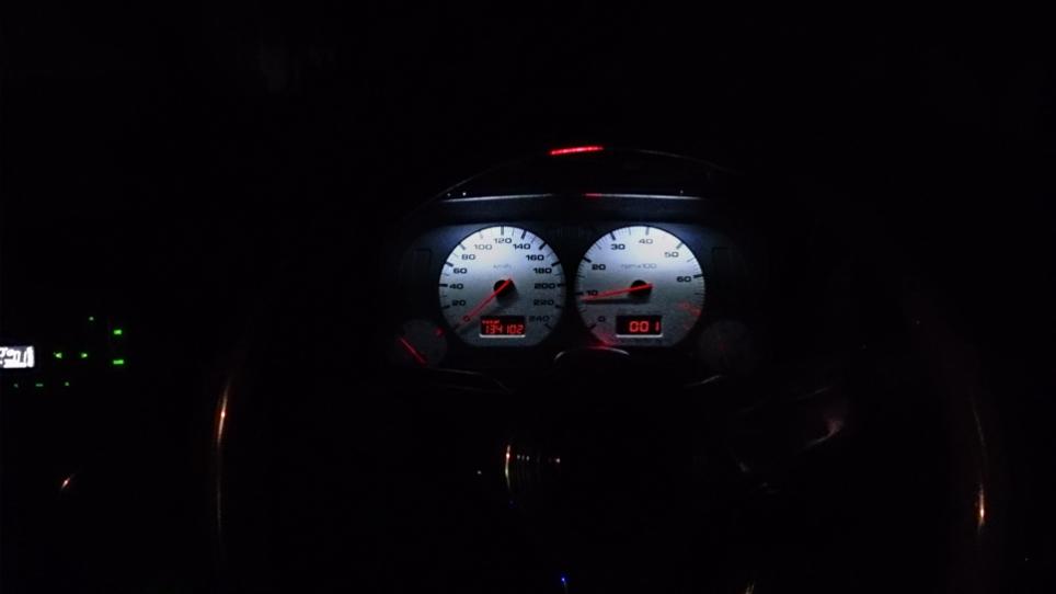

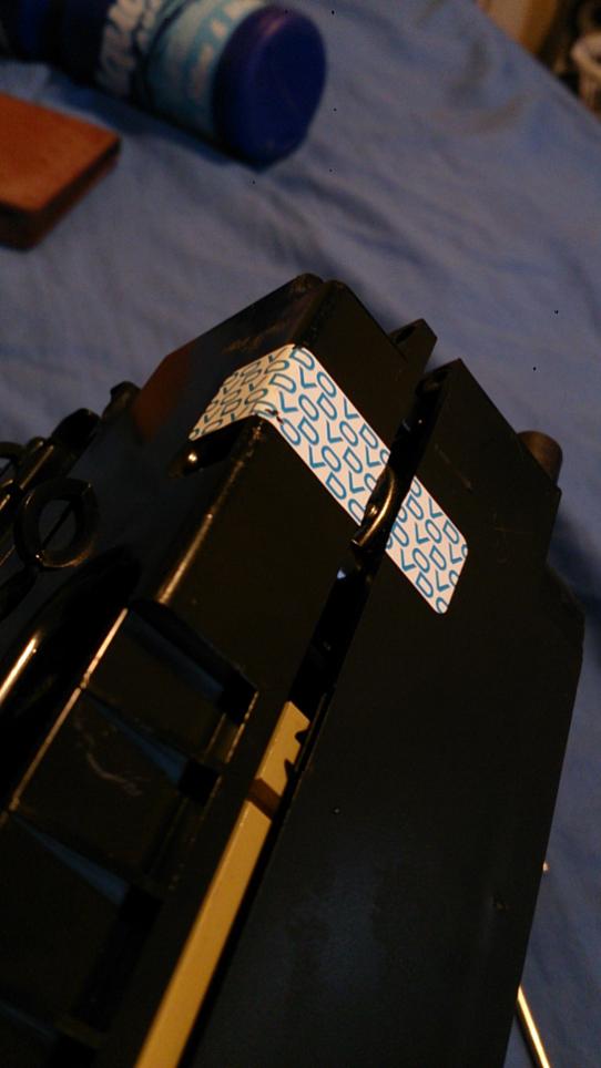

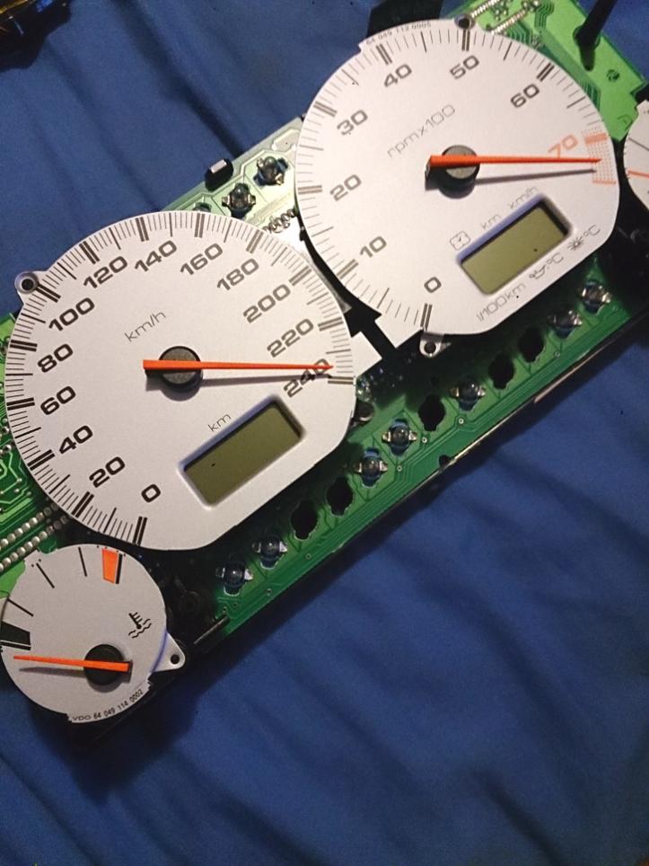

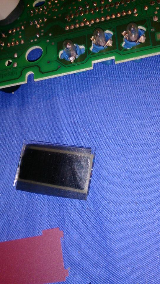

                  Also bought some GTI clocks though the SEAT's light up orange and no one likes orange. whilst I was there I "flipped" the lcd.... (I'll throw up a DIY if there's interest)
                  Voided warranty?
                  BRAAAAAAP! yeh right.... haha

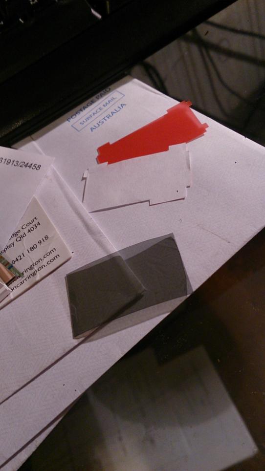

                  The polarising films are pretty cool, here's it removed;
                  First pic is the standard way and the second pic is just the film flipped over.
                  New light "filter" (piece of cut out paper)
                  and done!
                  I had white LED's for the lcd's to light up the digits white but they're too bright and they actually lit up the dark section a ****ty blue colour, so the standard bulbs will do for the moment till I figure out what ima do to achieve white digits.....
                  Now I opened and closed and installed and uninstalled this cluster I don't know how many times to get this right so like I said earlier, if you're interested, i'll make a DIY for everyone to follow with my tips included....
