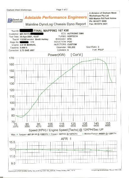

    Feels great at about 3500rpm when its starts boosting up, also love the S/C whine. The BFI stg1 mount that have just gone in take abit to get use to, but supposedly soften up a little bit after a week or so.
    Makes decent power for a 200,000kms stock engine that has alot of blow-by, about 220hp at 6500rpm.
    I do all the work myself, except the tuning which was done by Graham West Workshop in Adelaide (Autronic dealer in SA) and machining work on my new engine all done by Chris Milton Engine Development in Adelaide also.

              I paid about $5000 landed plus customs fees.
              Wheel spin, yes, 1st gear above 4-4500, and on change into 2nd. In the wet also wheel spin at the top of 2nd 6000rpm. but the tyres i have atm are siht (sava intensa). Got some Yokohama semi slicks lined up.
              As for the Autronic the standard wiring loom is still in place, i just ripped the guts out of an old ECU and wired the SM4 loom onto the back of the plug, so if i want i can easily go back to the standard ECU. Next setup may replace the entire engine loom, don't know yet. The ECU is in the same place as the original ECU but inside a water proof box, as they are NOT water proof.
              The other benefit of the Autronic is it made about 20wkw peak more than the supplied GIAC chip.
