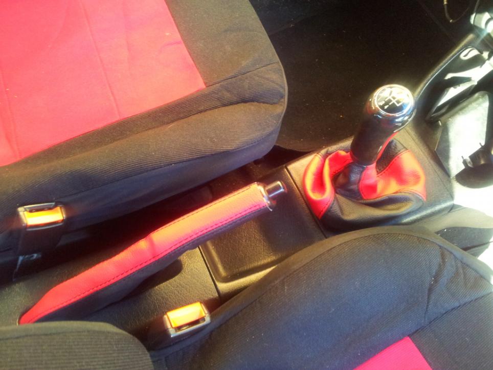

new red/black leather gaitor boot and handbrake cover
Hi All
I dont want to sound like all I do is talk about problems! we have been making progress
Nice new red/black seat covers
the steering wheel is well worn , so am waiting on a red black stitched leather wheel wrap
---------- Post added at 05:42 PM ---------- Previous post was at 05:41 PM ----------
also forgot to mention , new woodgrain gear knob that shows my daughter which way is reverse!

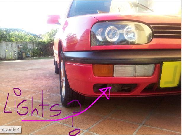

gaping hole on both sides
what should i do here?
some type of day running lights ? what are my options?

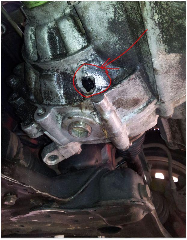

I spent a bit of money got the roof and passenger door window done, feeling good with progress but then driving on the weekend "Wack, sounds like a rock hit us underneath , oil smell then a burning smell." I pulled over and can see a good leak coming out. It wasn't engine oil or coolant or steering fluid. It looked like coming from the transmission. I managed to drive 10k home ok .
I got undernealth the mk3 and I found a hole in the bottom of the transmission case about the size of a 5 cent piece. It looked fresh so I guess we were unlucky enough a sharp rock has taken a chunk out of the transmission
I went to superdumb and bought 2 pack metal epoxy managed to fill the hole and it set nicely. It goes off in 4 minutes , then later on I refilled the transmission with new fluid through a plastic plug at the top. Then to my surprise it all came leaking out again (not through my repair) but a different spot.
I can take photos and upload , but I had an awful feeling maybe that plastic lug at the top of the case was not the right fill spot.
HOLLY ****......... wtf happened there :/...... and you're not even lowered ...... unlucky son .... as for the fill, do you do it through the speedo cable? I haven't looked on my 2L yet but i'm gonna drain it soon......
