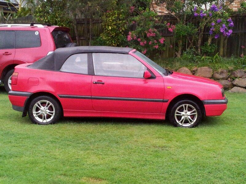

            well here is the cabrio, the paintwork is a real red , I think my phone camera makes it look a little washed out

                        hot start is the least of your worries, LOOK AT THE RIDE HEIGHT DAAAAAYYYUUUUUMMMMM!!!!
                        seriously though, nice pick up!

                          ride height looks low , but i hope it is legal, but i dont have the safety cert yet, fingers crossed
