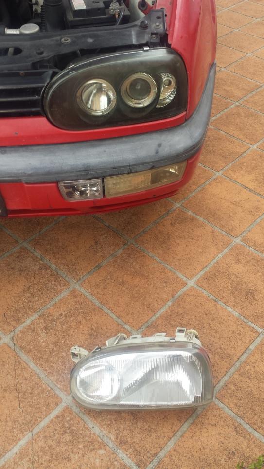

        aftermarket headlights need adjusting - hope someone can help me?
        hi All
        Been a while since I have been on here, the MK3 has been good .
        The headlights need adjusting hope someone can help me. The PO replaced both headlights assemblies with different types with led halo rings. So I can't just follow the book. The dont seem bright enough to me but first thing is to make sure the angle is adjusted .
        the Golf manual says on the stock units there are 2 screws a) up/down b) left right b but on this set up I can only see one o'bvious screw but this assembly is different
        I dont want to go screwing it in and out without knowing if i need to loosen any other screws?
        you can see the screw above the light wiring

          How did you go with the gearbox all that while ago with the rivet, new box? What did it run you up? Im looking at droping mine out reverse its abit noisy. Are you changing back to original headlight?
          Sent from my D6653 using Tapatalk
          • #50
            gday mate
            jimmy mac got a 2nd hand box and swapped it for me. it has been good.
            no i will keepb these lights add i assume they are better.
            However it is not obvious to me how i adjust them.
            i hope some one can advise
