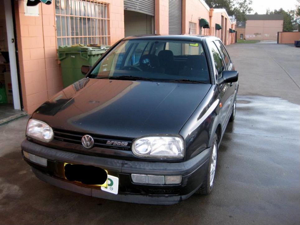

    Here she is...
    She sounds like a beast but drives very smooth!!!
    All designed on paper before parts were ordered and she was brought to life
    Mods include...
    82mm pistons - Mahle's
    re-balanced crank with ECS front pulley
    Standard rods
    New oem oil pump
    Ported head with 1mm larger inlet and exhaust valves
    titanium collets and retainers
    lightweight lifters
    262 cams, didnt want to go any bigger being an auto
    extractors and full 2 1/2 inch exhaust
    new timing chain kit, water pump, 80 degree thermostat
    rebuilt driveshafts
    rebuilt auto with larger clutch packs and stronger oil pump .
    external oil cooler for auto
    Giac chip with larger 280cc injectors and adjustable FPR
    new lambda probe
    schrik manifold
    custom cold air intake
    Catch can
    R32 external radiator

    Sleeper much
      and we have a winner! good job man!
      who did the engine work?
      with the adjustable FPR and bigger injectors it doesnt seem like your too concerned with fuel economy, but ill say it anyway, with the 80 degree thermostat you'll probably use a bit more fuel, unless the giac chip can factor it in. (other wise its always going to think its not hot enough, like its just warming up so its gonna run rich like at idle, you know?)
      stealth mobile!
      -steve
        Sleeper much
        You can say that again.
        Hope you're getting nice, wide rubber for that lil' beast you have there.
          stealth mobile!
          -steve

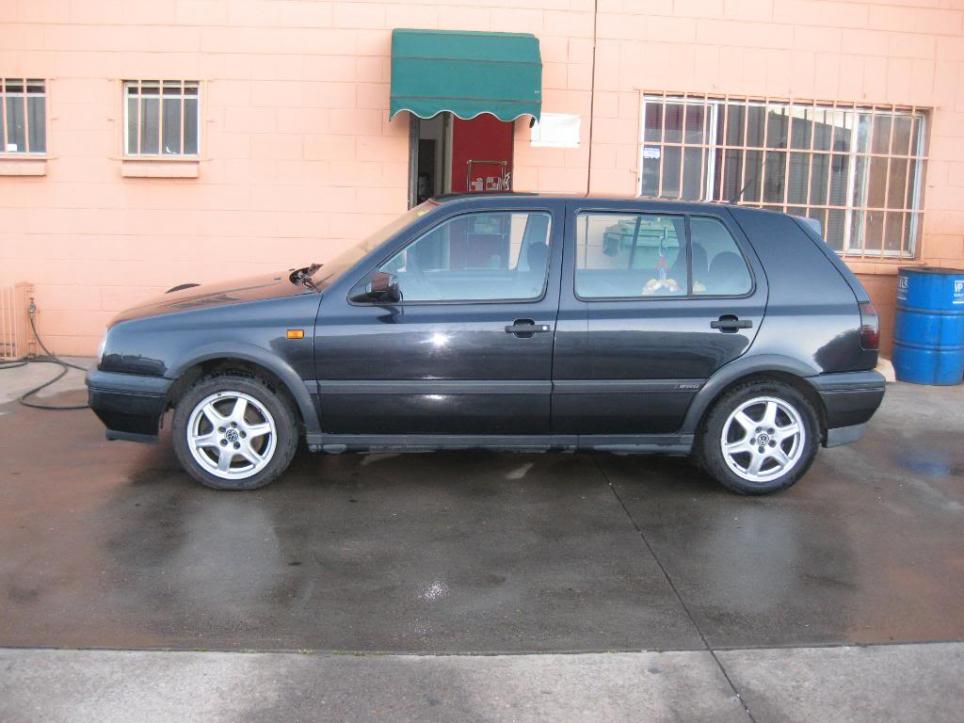

          Seb did the work, its certainly the coolest Auto VR6 kicking around I recon!!!
          how does it go Courtney?
            I wonder how long the tranny will last lol...
            Dyno'ed it at all?
              Yes Seb did all the work
              although i did do the cleaning!!!
              she is running real nice... i value my licence so i havent run her in good yet
              taking her to Warwick over the weekend so will let you all know how she goes then (itll be my first time on the track so i hope i dont fail her... and Seb!!! )
              getting new tyres (Pirelli p6000) and a wheel alignment tomoro and then we will really be rolling
