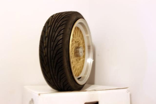

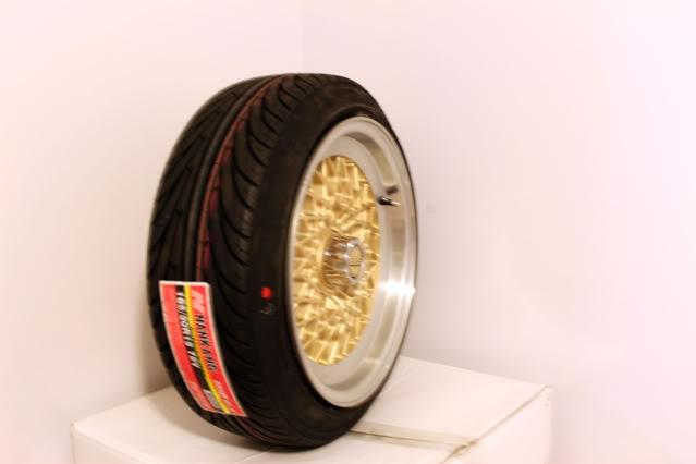

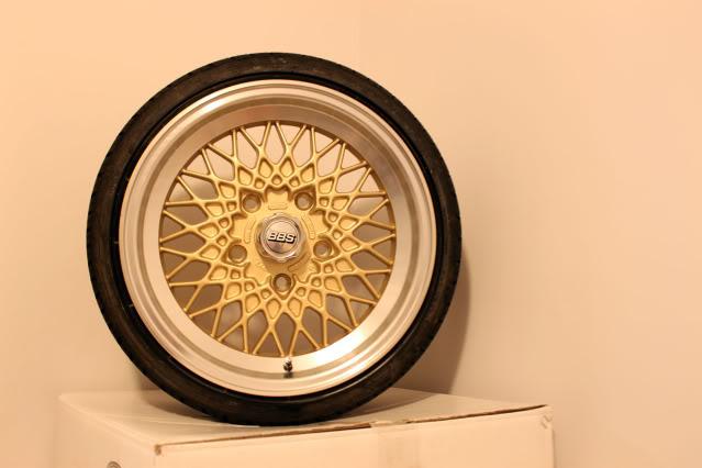

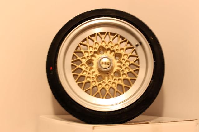

                              Here's some pictures, sorry about the below average quality, they were really quick!!!
                              Fronts:
                              Backs:
                              • Sex. Pure, unadulterated sex.
