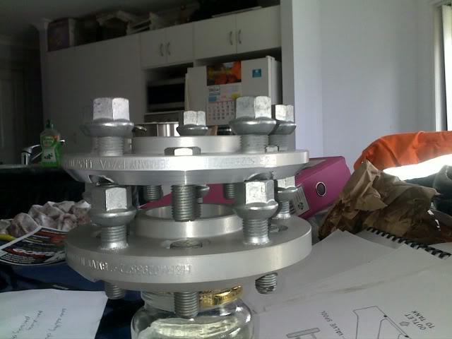

              So I have run in to a small problem, see here:
              You'll notice the bottom adapter is perfectly fine, the wheel nuts are on, and the bolts poking through (facing down) sit flush.
              The adapter on top however, nuts are fine, but the head of the hex bolt protrudes ~3mm. This is the wheel mounting face.
              I was wondering if H&R had a different set of bolts (I need 10), as the hex protrudes past, but the 60* taper may also be the root problem (Ie it's too long).
              Anyone got ideas, have emailed the gentleman that got them in to the country for me as an enquiry, to see what ECS/H&R say.
              Only alternative I can think of iss to CB the wheel face to clear the bolt head, but I REALLY do NOT want to do that...

                  Mine came with normal hex head bolts without the ball seat, thats how they manage to make them sit flush in a 15mm adapter and not have that 3mm protrusion your worried about. Your wheels are flat backed i gather?
                  EDIT: Just thought about this on the way home. im a idiot...

                  • How much do you have to play with? Just throw the things in the lathe and face the excess off!
                    You could also deepen those counterbores a bit more, maybe?
                    • Yeah's I know. I'll get the hex faces machined off if I don't get a good official answer Chris. Not too hard to work out. Just seeing if there was another opinion on the matter.
                      Shan't be too long till I get it all sorted though
                      • You could possibly buy 10 wheel bolts with a shorter head, but yes, must be frustrating H&R didn't provide the hardware for them.

                        • had to do this with a set i have,send em down and i can sort em for you if you wish

                              PS. Had no luck with finding replacement bolts for the adapters (ECS/local Hi tensile bolt company) so will shave the hex face. I can't see a problem with this (though let me know if you can?).
                                I'm no engineer so don't know what it would do to the strength of it, but only problem I could see is potential rounding if you're not careful have the socket seated onto the bolt before you start torquing it up. You shouldn't have a problem
