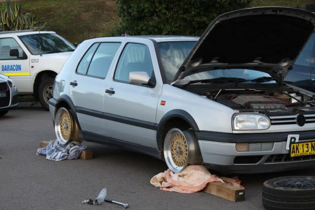

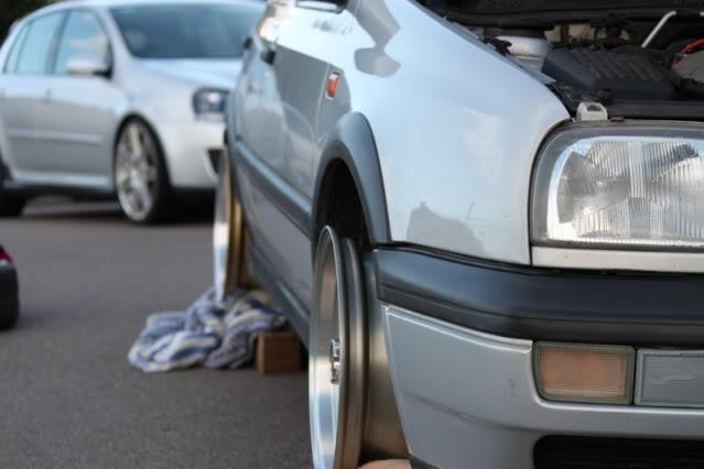

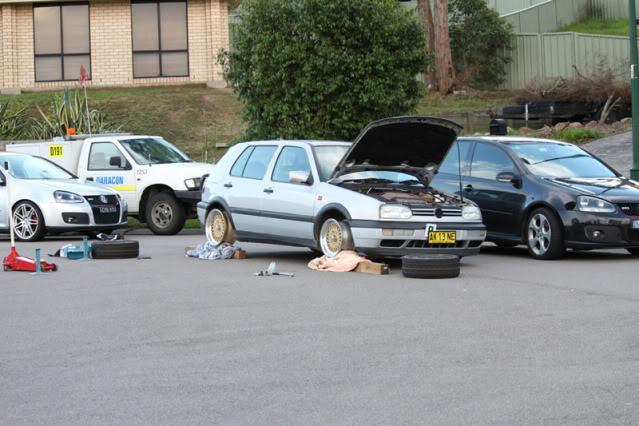

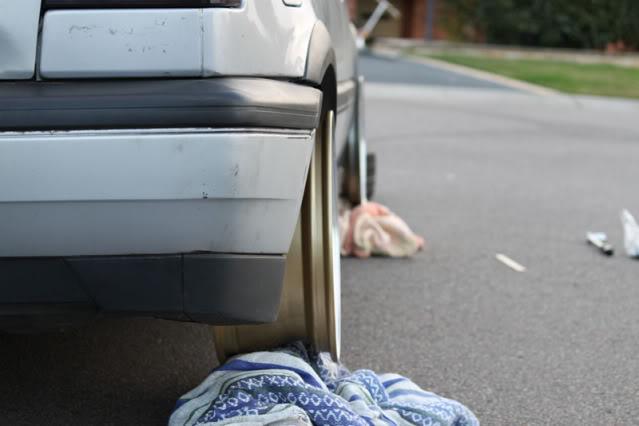

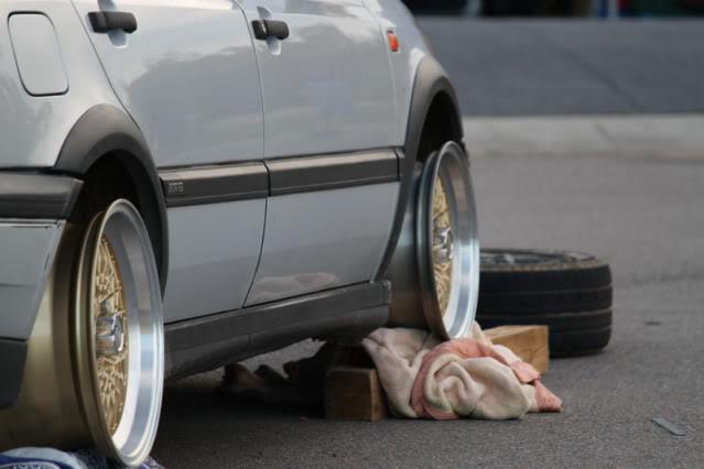

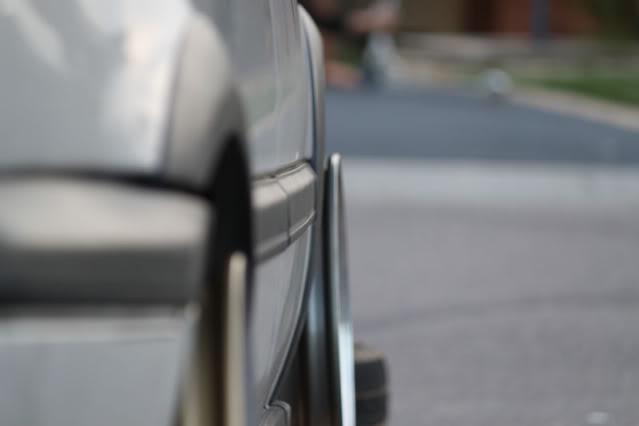

Rears apear to be perfect, fronts poke plenty eeeeek! Weird considering I got the smaller adapters for the front :S
My front calipers will need a small shaving, not the actual piston carrier body though, just "excess metal".
The front adapter bolts, the actual head of the bolt that bolts to my hub is too big, (the hexagonal part) so I need to remedy that. That should bring them in 3 mm when thats fixed, then properly on the ground im hoping another 3, wind in a bit of camber and it should be all sweet
Still undecided on tyres though!!!
