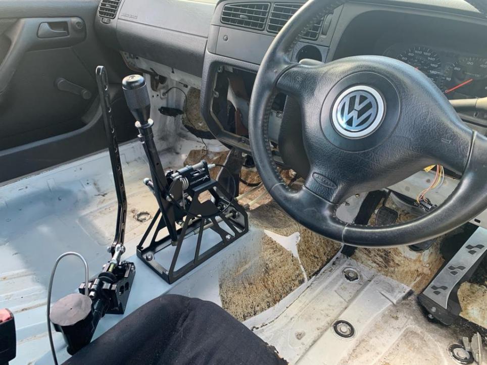

            Got all the fabrication stuff done over the last little while.
            Dropped some of it off to be powder coated. The rest in aluminium will just stay as is.
            Sneak peek of the front end with the new fuel cell.
            The shifter and handbrake plate was welded into the car for ease/strength. This has just been rust proofed for now.
            Eventually when the car gets fully stripped this will all be painted properly.
            In the meantime. I’ve gone through every nut and bolt to check and mark tight, borrowed the wot box from the R32 so can at least have some sort of launch rpm assist on the slicks and some other general bits and pieces.

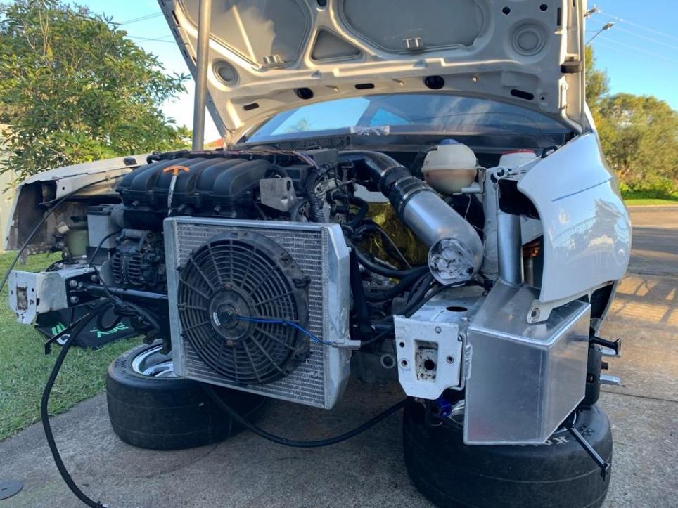

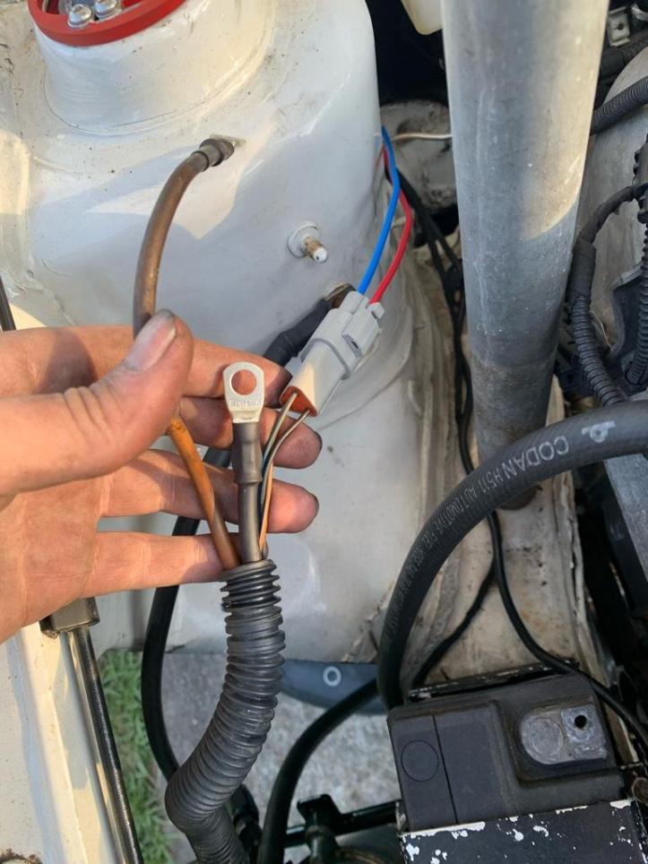

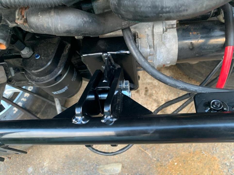

              Few more bits and pieces done. Wotbox has been a little bit of a hassle; doesn’t want to work with the ECU. So not sure if I’ll be able to work around it not.
              Reassembled the front crossmember and bumper mounts, put in the power steering pump and wired up, radiator fan wired up, fixed a split injector o ring i found out about this morning when I started it.
              Fabricated front engine mount
              Electric power steering pump hiding away
              Terminated ends, switched power in the deutsch connector, that goes into the switch panel inside
              Passenger side bumper mount and backside of fuel cell
              Mismatched radiator hoses, but what was laying around!
              All together

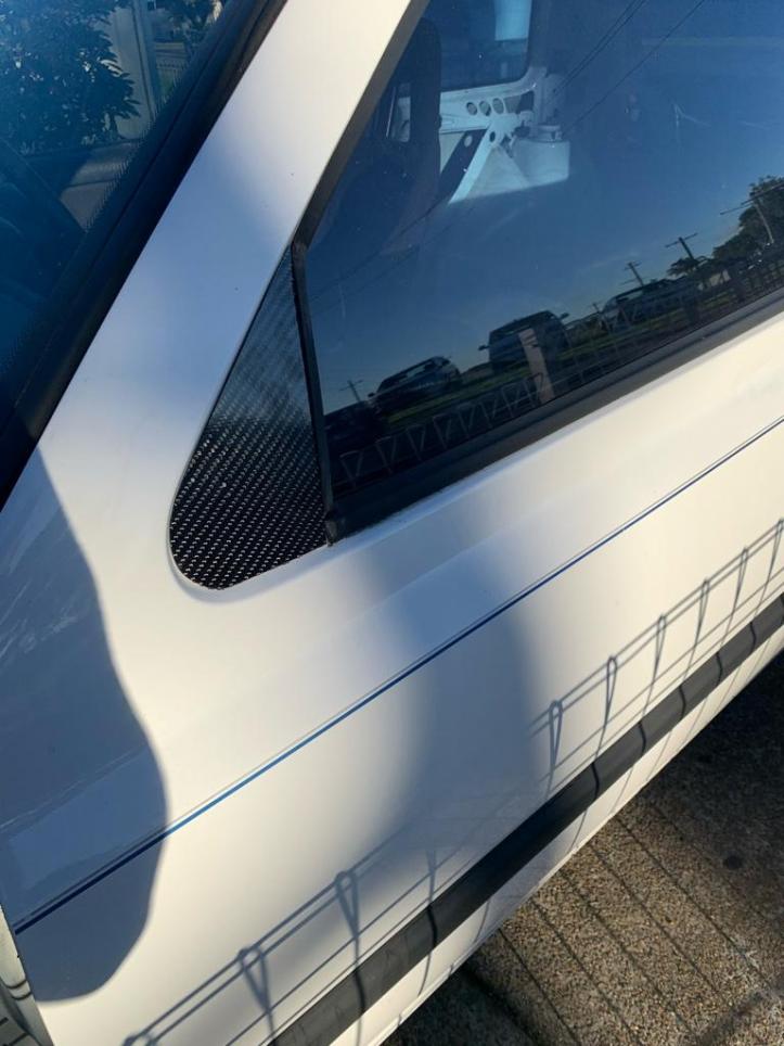

              Annnnd, made these mirror deletes out of a sheet of carbon. Will be making a centre fascia/switch panel out of the same sheet.

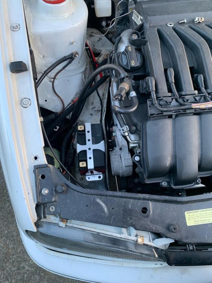

                    Another day, another bunch of jobs ticked off the list.
                    New battery mount to suit the new lithium battery. Total weight of the new setup 1.5kg vs the previous setup of 10.2kg

                    • #55
                      Is the tiny battery any good in a daily?
                      • #56
                        It’s 500cca, so 1.5x more CCA than the old battery that I’ve used in a variety of daily’s for the last 5 or so years.
                        It is a lithium battery, not sure how it would compare to AGM or lead-acid battery in terms of longevity.

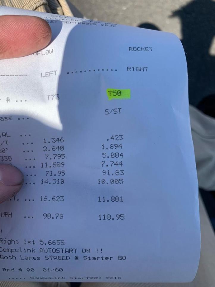

                          And after putting it off for ages. Finally got back to the track today to make some passes.
                          First pass ended up being the best.
                          11.881 @118.95 MPH
                          3.6 swapped MK3 11.88 @118MPH - YouTube
                          Go pro suction mount wasn’t cooperating so no in car footage this time around.
                          Few little things to attend to, radiator drain plug started leaking. Traction still a massive issue.
