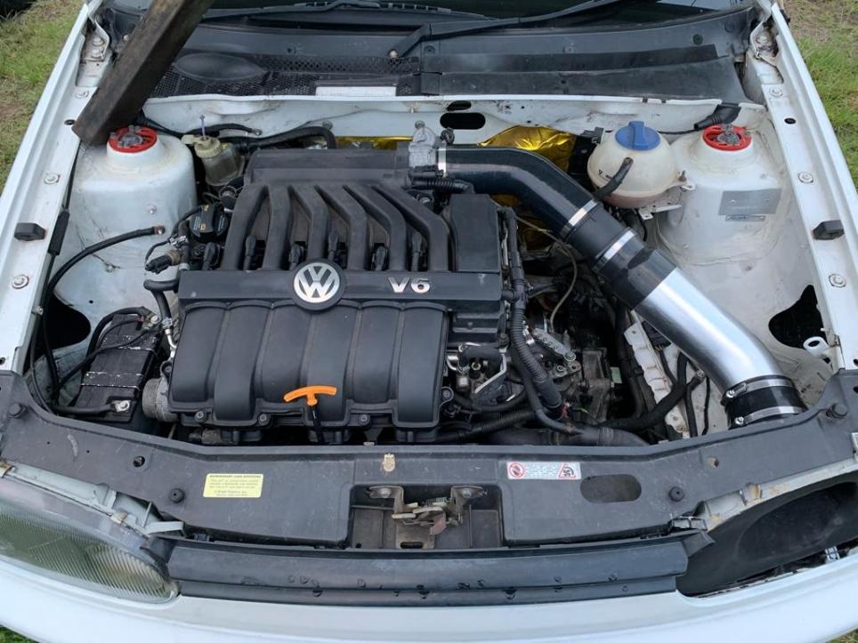

            • #21

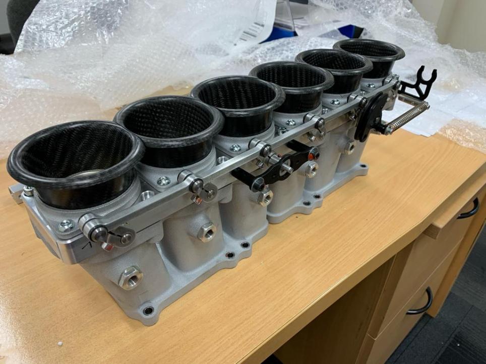

              Should look a fair bit more wild with these things in the engine bay too!

                Soooo good. Keen to hear this thing under WOT

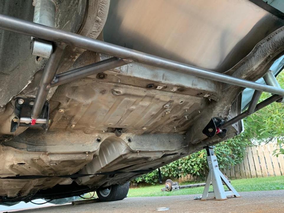

                  Hacked up the rear of the car.
                  Stripped out the interior and fitted up a sparco seat.
                  Myles coming in clutch again with a tubular rear beam
                  The rear beam is in aid to fit this lightweight rear brake kit. Totalling a whole 7KG for both sides.

                    Jesus Hayden I only just found this thread. Mental! ITB's are amazing even when they're sitting on a bench. Its going to sound brutal. Good work mate.

                        Can’t wait to hear the VR6 itb doorrrts

                              Got some time to get the rear beam finished off. I was sent the wrong wheel bearings so had to pause at the stage of getting it fitted up.
                              Quick scuff back and a coat of paint and it’s in. Wheelbase is extended by around 30mm, with ability to extend up to 70mm, provided the tyre clears the rear bumper.
