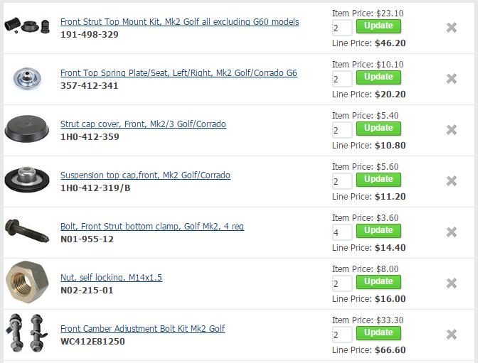

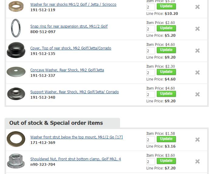

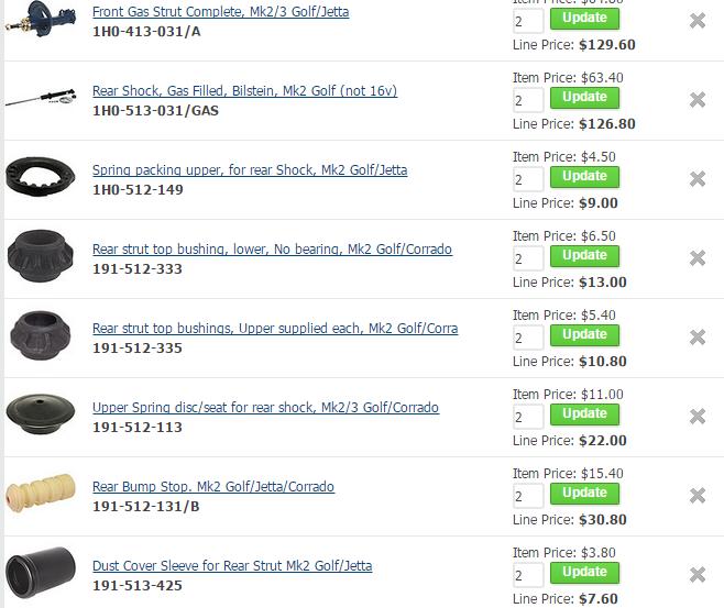

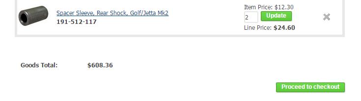

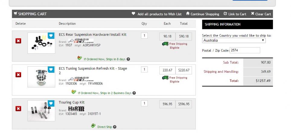

                    I did a few dummy orders on suspension today
                    First one was at VW Heritage for quality gas shocks (Bilstein i think) and new strut top mounts, camber bolts, pretty much everything that the suspension touches excluding control arms
                    Cheap coilovers are out
                    I did another at ecs for the H&R Touring Cup kit and a front suspension install kit and rear suspension refresh kit. (and i think thats in USD!)
                    I'd love the h&r kit but its a damn big difference. The install kits do give me more bits than i'd have ordered from VWH but once i take into account currency conversion, we're approaching what i paid for the car.....
