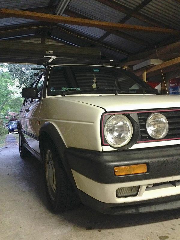

                Got some 2nd hand roof racks and fog lights from The Scotsman to replace the one with the broken lens. This thing's getting more and more Euro everyday. Hence I've decided to name it Illyana

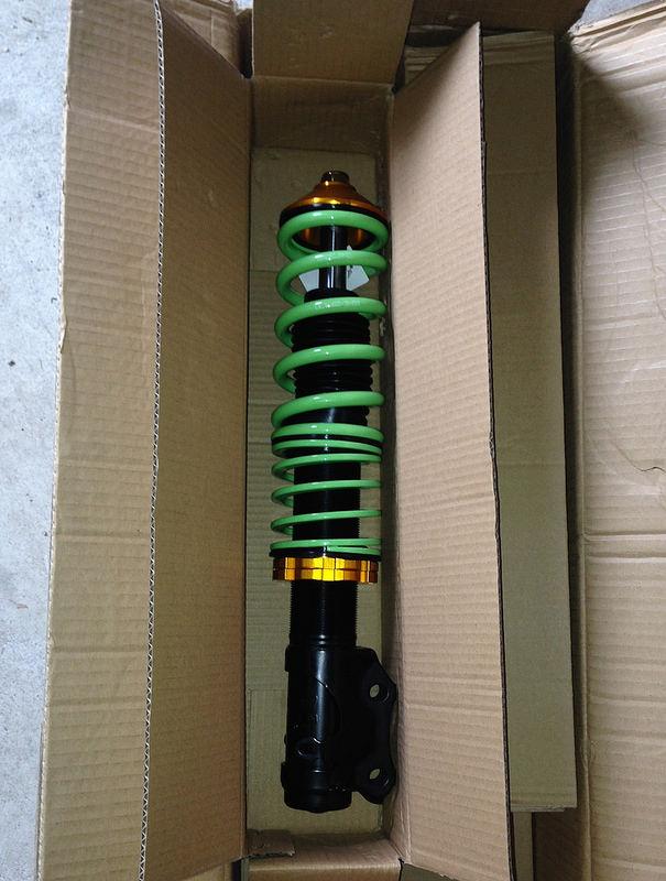

                        Coilovers arrived today

                          How much did the coilovers end up costing with postage?
                            Total came to $604US shipped to Sydney
                            aka Elbo

                                Are they Weitec coils?
