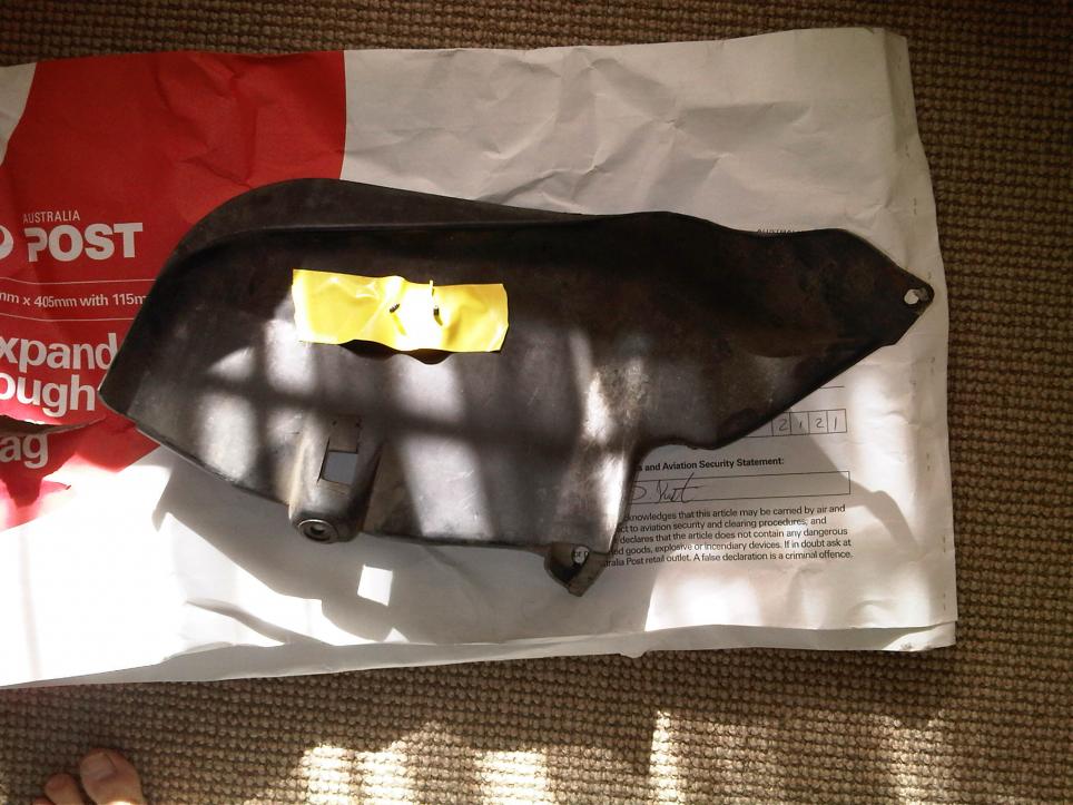

    • #32
      Got this in the mail today. Thanks Lucky13. No more cut up ice-cream containers on this car! Hopefully no more squealing belts either!

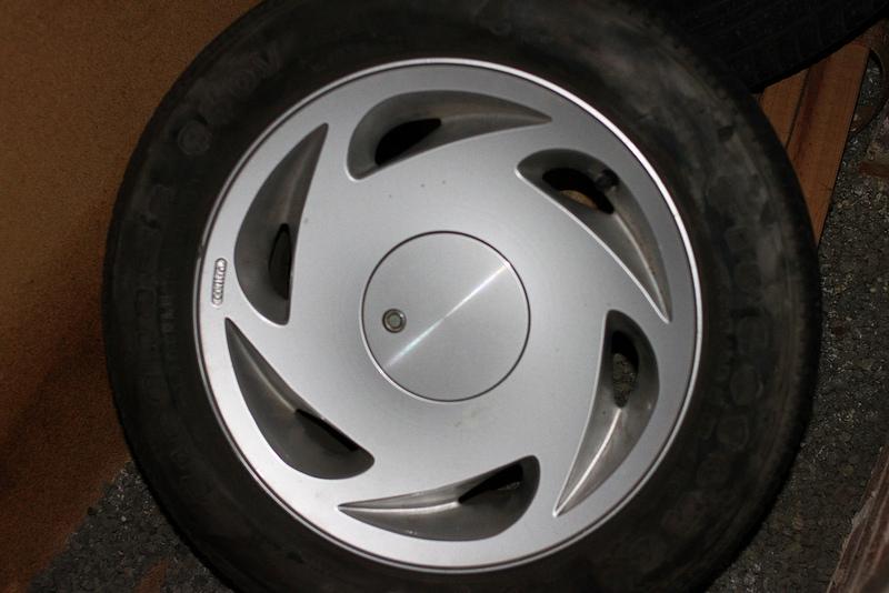

      • #33
        New wheels for the Mk2

            • #36
              With those window scrappers? Did duby have a whole bunch? or just a once of getting rid of spare stuff?

              • #37
                He had a few sets and a few others bits and pieces, looked like he was starting up a bit of a shop. Maybe send him a PM and see if he'll be getting any more in soon.

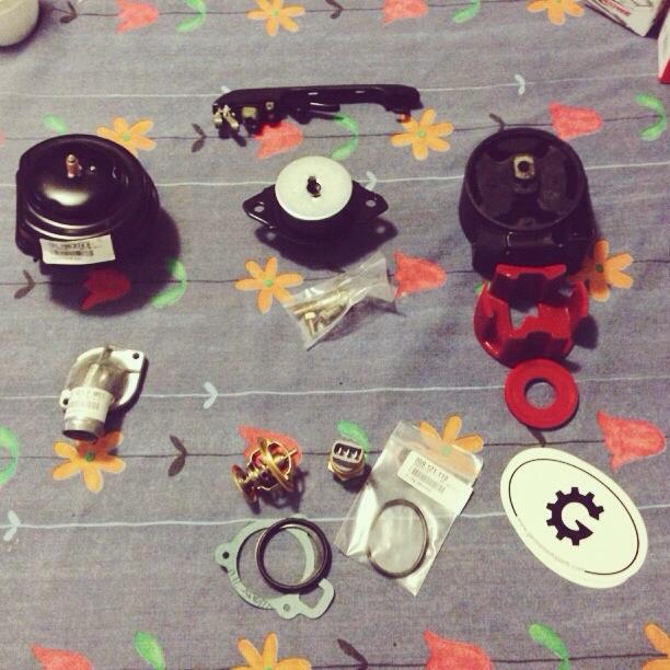

                • #38
                  A few new parts arrived today. New engine mounts, thermostat and thermoswitch, door handle and thermostat cover

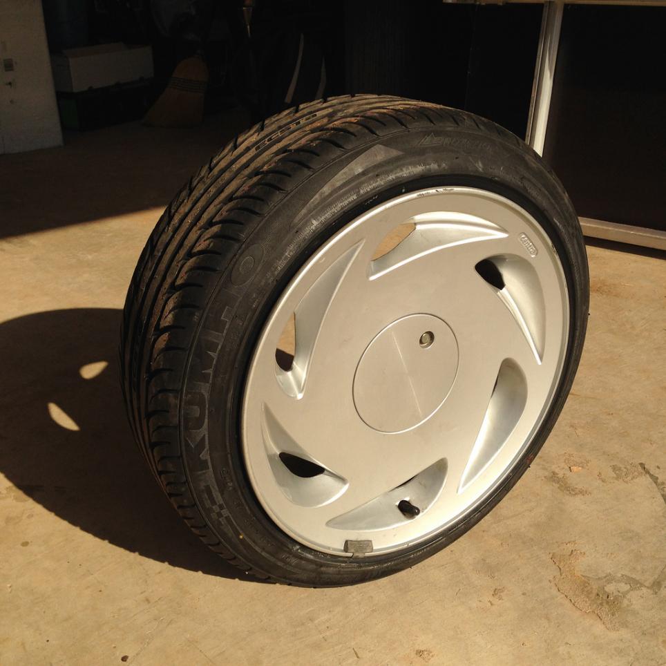

                  • #39
                    Wheels are ready to go. Just need coilovers and to work out spacing on the rear.
                    aka Elbo

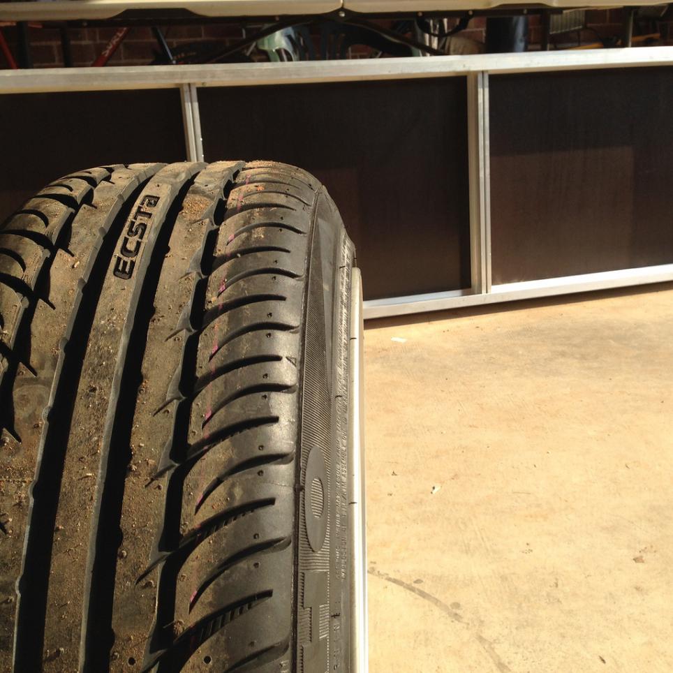

                    • #40
                      i recognise those tyres!
                      where did you end up getting them?
                      • #41
                        Haha, yeah, checked out Ozzy Tyres after I asked you where you got yours and saw they were on sale, so committed and got them. (Thanks for the info!) Its a sensible stretch and looks good I reckon. $88 each fitted was pretty good too.
                        Hopefully get the rest of what I need by the end of the year

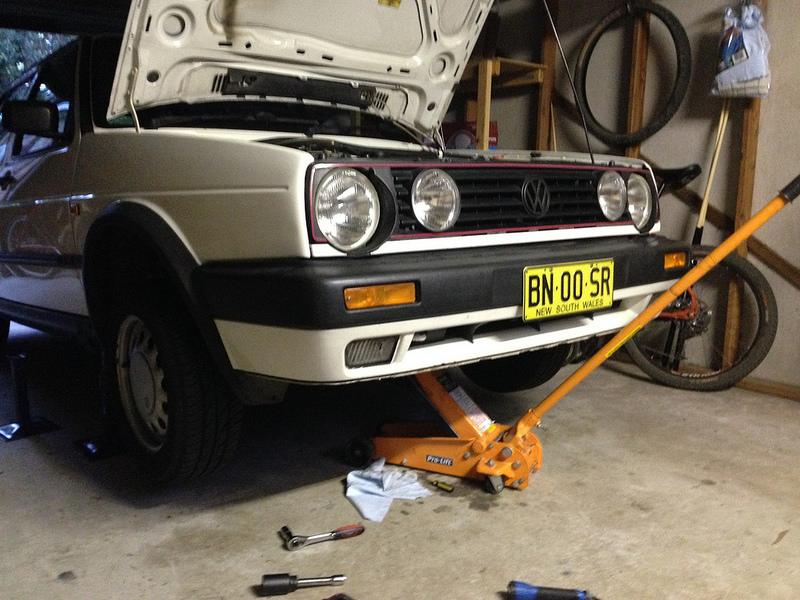

                              • #45
                                Got a day off work tomorrow, so I lifted the car tonight to get a head start on replacing the engine mounts. They are in much need of replacing. Did the front one tonight and I've got the other two ready to go for tomorrow. Putting a rubber mount with poly insert in the rear and a poly BFI mount in for the trans mount. Not solid, but stiffer than stock mounts.
