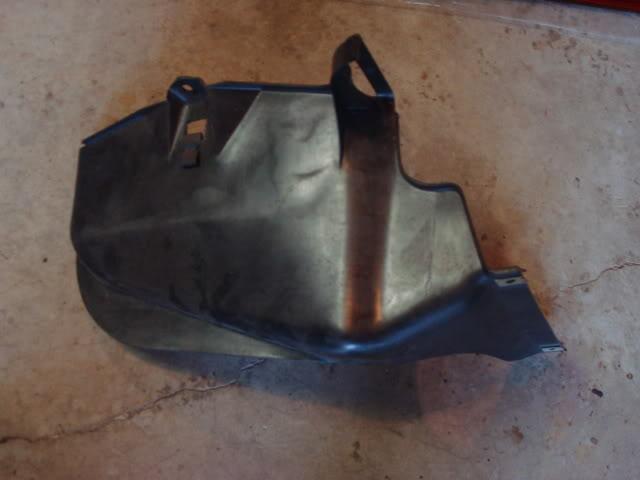

                      Originally posted by ryana89 View Post
                      Do you have 2 plastic covers (splash guards) around the belt area?
                      The main one looks like this,
                      And then a smaller one that attaches further forward under the front spoiler.
                      You'll find its the big V-belt that is slipping as it drive's the WP, A/C and in turn the load of the alternator.

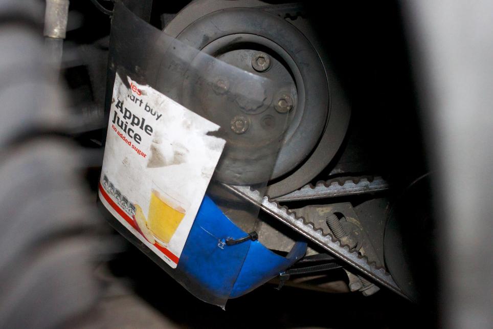

                        Originally posted by robiom View Post
                        Touch wood I solved my belt noise by getting a 11.5 x 730 from Autobarn. It fits the slightly worn pulleys better than the standard 9.5 x 725 version.....This was for the PAS / waterpump (most outer belt). I don't have cover either, shall have to eat more ice cream to get the tub reasy before winter
                        Thanks for the info! I can't remember what size I got (still have the packaging, so I'll check). Might be worth trying your fix.
                        Here's my attempt at the ice-cream tub fix. I struggled… lol! The belts still squeal, but the battery light comes on less now, so its helped keeping the load up to the alternator in the wet. I think I just need to go and get a cover from the wreckers!

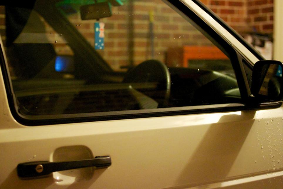

                              Picked up some new window scraper rubbers from DUBY today and installed them tonight. They sit nice and tight against the glass now. No more wet carpets or duct tape on the windows when its raining for me!
                              aka Elbo
                              • #30
                                Hey Brumma,
                                You do know its the foils behind the door cards that keep out the water....?
                                The rubber trims are more for show ....lookin good though.
