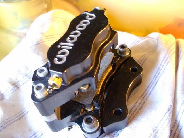

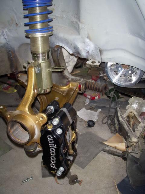

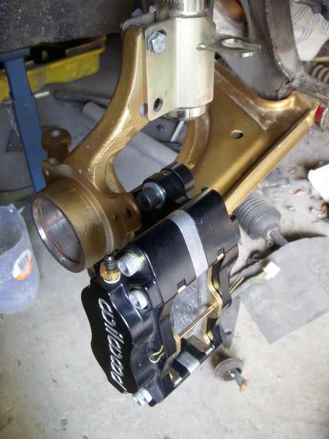

they shipped with no problems and where an absolute pleasure to deal with, i would recomend them to anyone

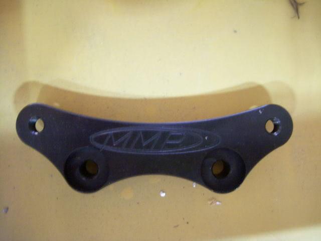

and some pics of the adapters and mock up
ahhh willwoods very nice indeed..I was always dreaming about those calipers and a Willwood pedal box so i could ditch the stupid linkage system in the MK1.Very stylish, i am jealous!

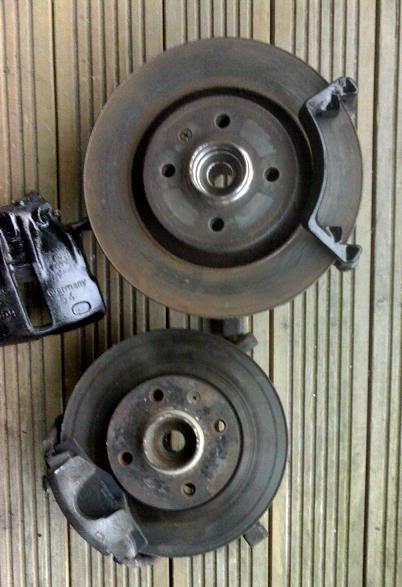

I have heard of some people using modded corolla discs as they have a taller hat height to help with rim spoke clearance when using small rims with big calipers, (in the setup i saw they used some heavy (but cheap) Volvo 4 pots) I think they give you an extra 10mm, and require the center bored out slightly.Might be 258's but cannot remember...

adapters from mmp $us190
so it works out cheaper
