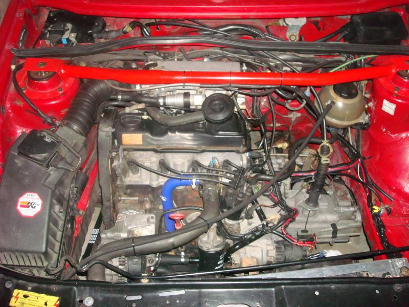

  • Originally posted by benough View Post
    You're not running it without an air filter are you?
    Haha nah it's going back in there.

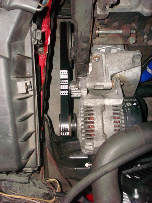

    • Originally posted by ryana89 View Post
      Your running a serpentine belt set-up?
      yes indeedy
      • Is that a Omp front brace? If so how did you get it to fit? Is there spacer between the brace and the strut tower? I have the Omp one and haven't installed it yet as it fouls on the Master Cylinder and slightly on the air intake tubing. It was also fouling on the Overflow tank till I lowered its mounting.
        • Originally posted by Bamish1000 View Post
          Yes, it was oxy? heated and bent to fit over the master cylinder, and yes there is a spacer made up to go over the strut towers to give it more clearance. The underside of the bonnet had to be shaved off since it sits higher than usual.
          Good luck mate
