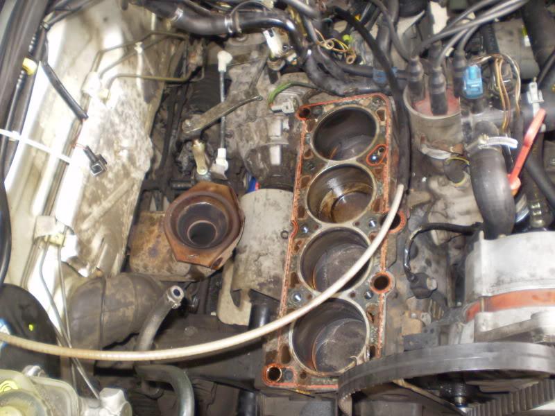

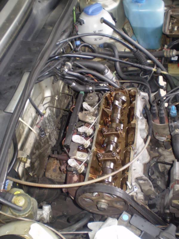

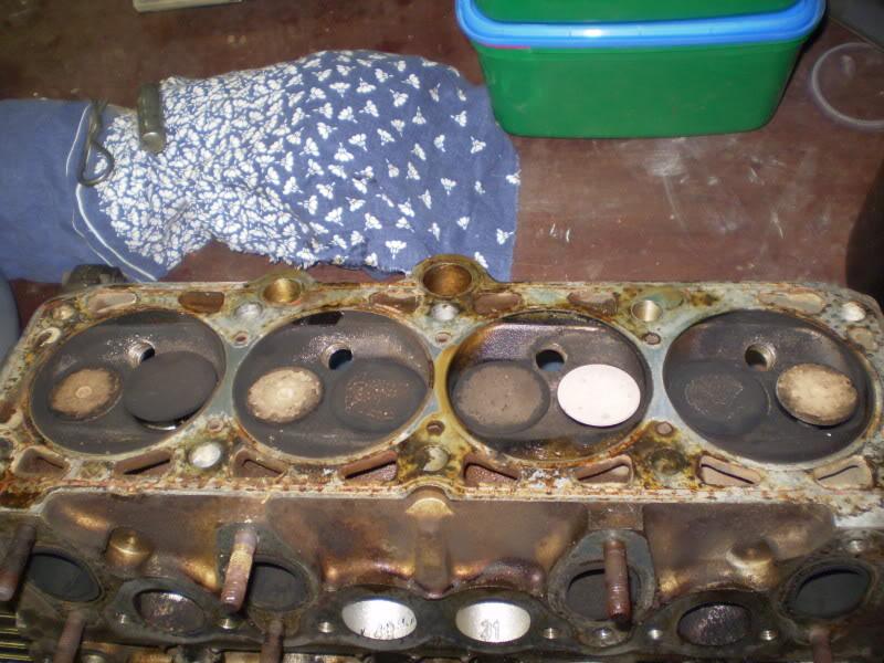

                  So I took the head off today, didn't take too long, but a mk 1 is just so much simpler! haha
                  Only took about 3 hours mainly due to the various manifold bolts being PIA's!
                  I havn't taken the injectors out, is there a special tool for that??? ( I dont want to break them afterall)

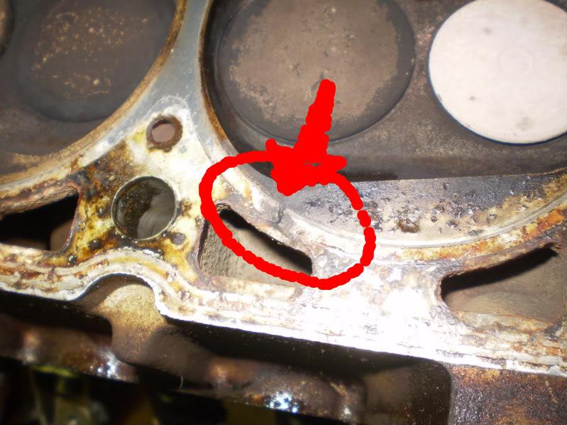

                  I had a quick look around the offending cylinder (3) and I've found what seems to be a small something, between a water gallery and combustion chamber, so I'm assuming that's where the problem was! Looks like I'll have to get the head shaved/machined just slightly. I'll take it down to RG Baker tomorrow morning, (on the bus ) and see what they say! (see last pic
                  Some pics:
                  yum!
                  Inlet off:
                  exhaust & head off:
                  head:
                  offending cyl:

                    You got off lightly!
                    I had about 3-4 of those.
                    Had to get mine welded up and ground. It was shiny as a bitch when it came back though!

                      Ah well, it'll go better when it's fixed.
                      I know you've got a twin pipe manifold to go in there but this method of expanding the clips of death is worth mentioning anyway.
                      How far are you going with the reco? If you're just going to get it skimmed I'd suggest you do the stem seals while it's out and de-coke the valves too.
                      I've got a tool for pulling the k-jet injectors, not sure if the digi injectors just pull out the same way.

                        speak to chris as he did my head, he will tell you how to do the injectors.

                            If you get a VRS gasket kit it'll have stems seals in it along with the head gasket and rocker cover gasket etc.
                            May as well pop them in it doesn't take long to do. Gimme a call over the weekend.

                                You just wiggle the injectors and they pull out IIRC. Once the rail is off, it's just the O rings that hold them in. Swift decoke and stem seals is worth the time, while it's all off.
