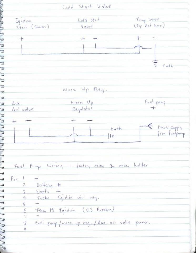

just wondering that screw that you adjust for the fuel mixture (a hole on above the air meter with an allen key) which way is rich and which way is lean?
and how to i wire up the cold start injector and timer? is it just a matter of powering the wires to ignition?

This is the very simplified wiring diagram I made for the K-Jet electrical system.
It doesn't have the TCI switch in there, as that's very easy to wire in.
Hope this help's.
For the doubter's, this is exactly how all my K-Jet stuff has been wired in & have never had a problem.
Hope this help's.

You need a long 3mm allen key for the mixture. Right is rich, left is lean.
I go in half turns and then quarters when you get close.
Tims sketch is tops. All you need on one bit of A4sigpic Camden GTI Performance. VW / AUDI Specialists
