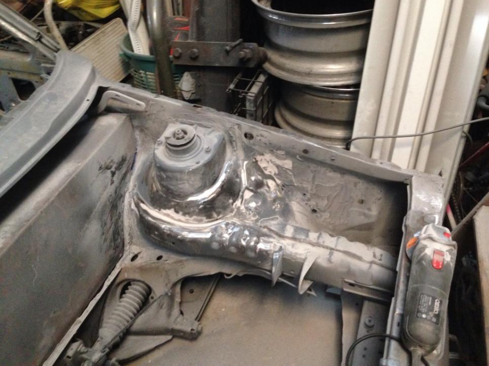

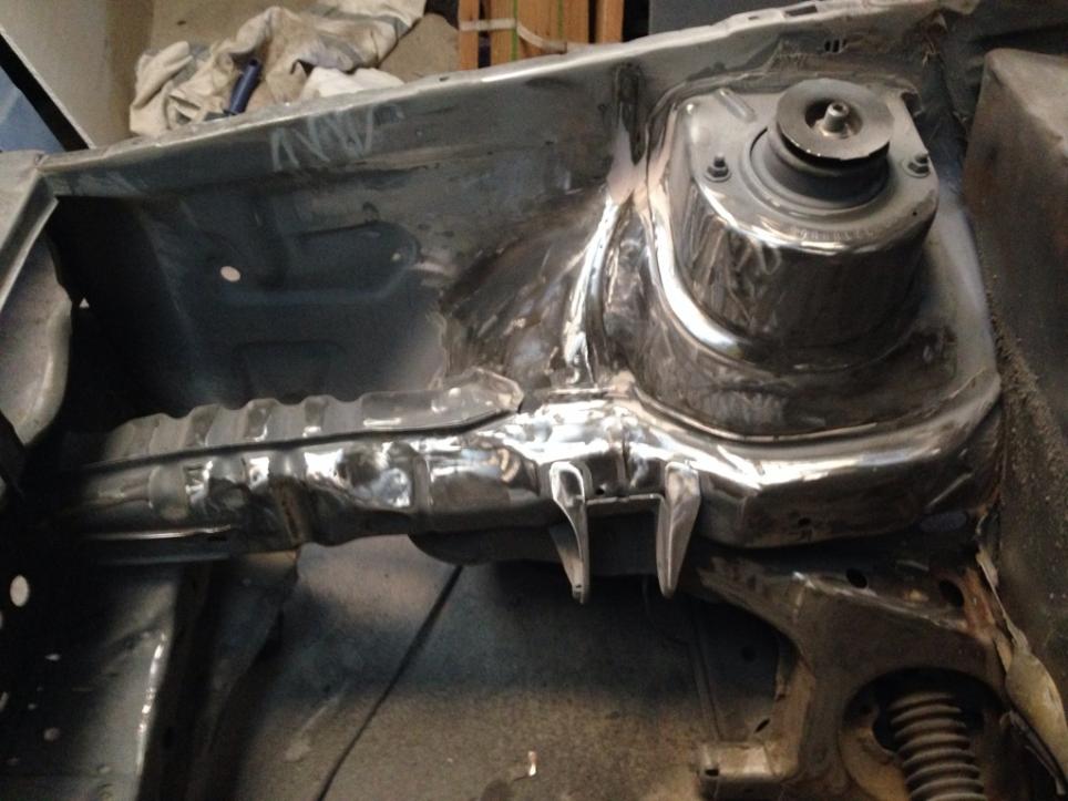

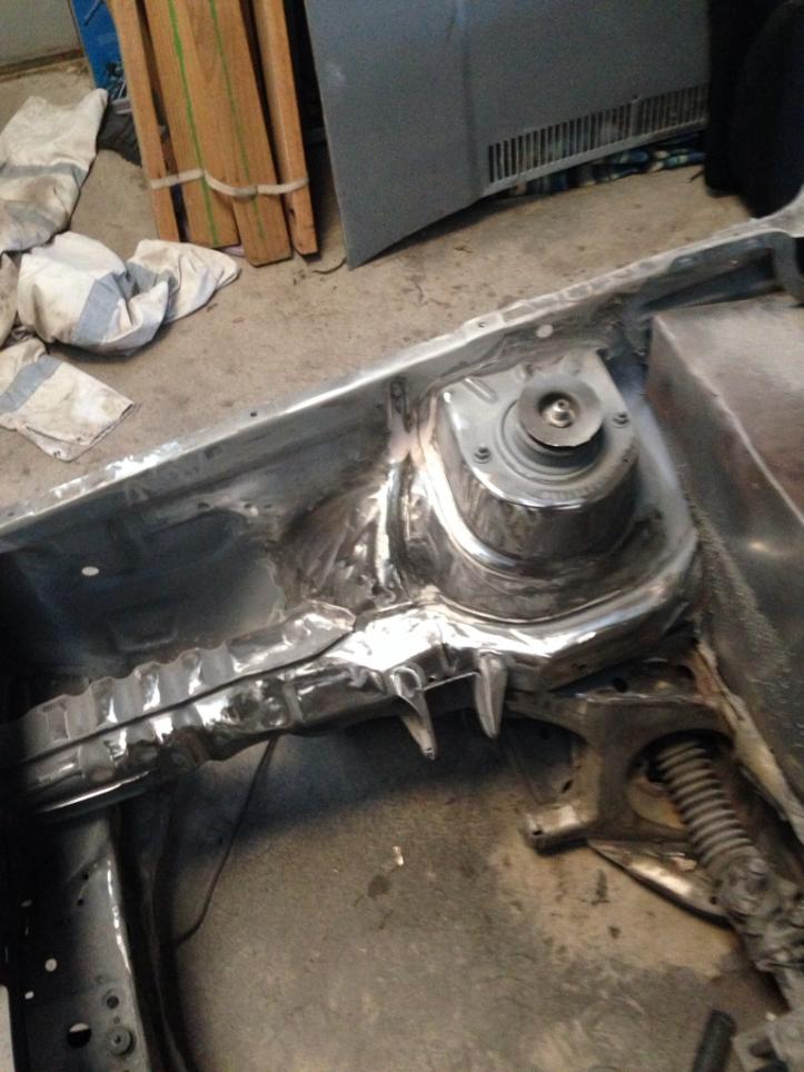

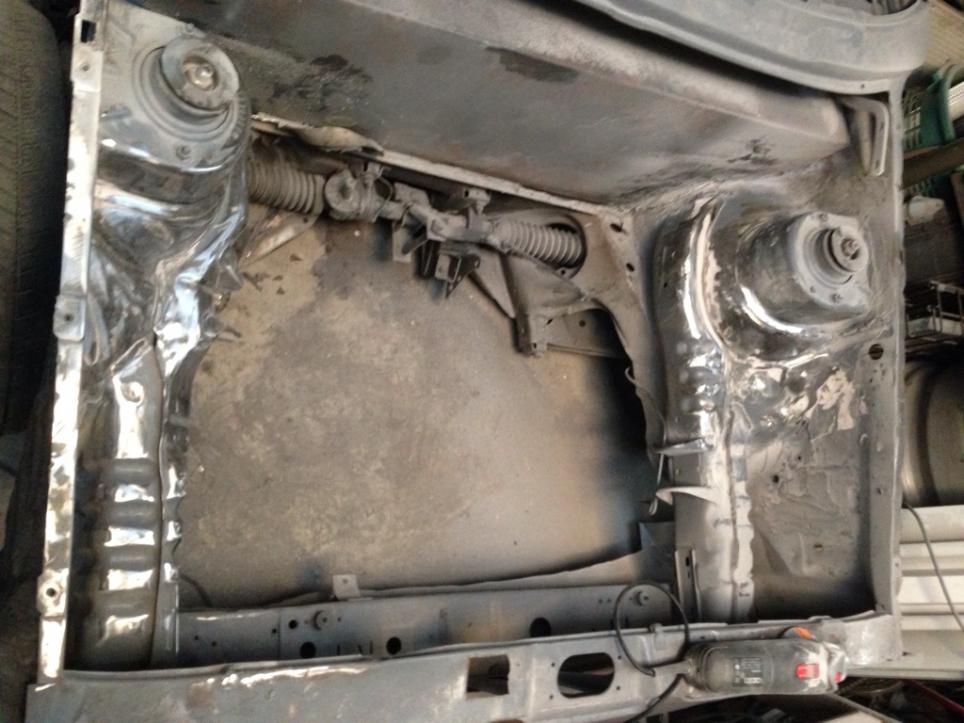

- shaved and tucked bay, re weld new firewall which is completely flat, seam weld the bay

hopefully will have updates very soon! although im rather busy at work and will be in the next few months up till december ill get stuck into the shell of the car with seam welding, cage, bay etc to be finished and painted before anything else happens!
