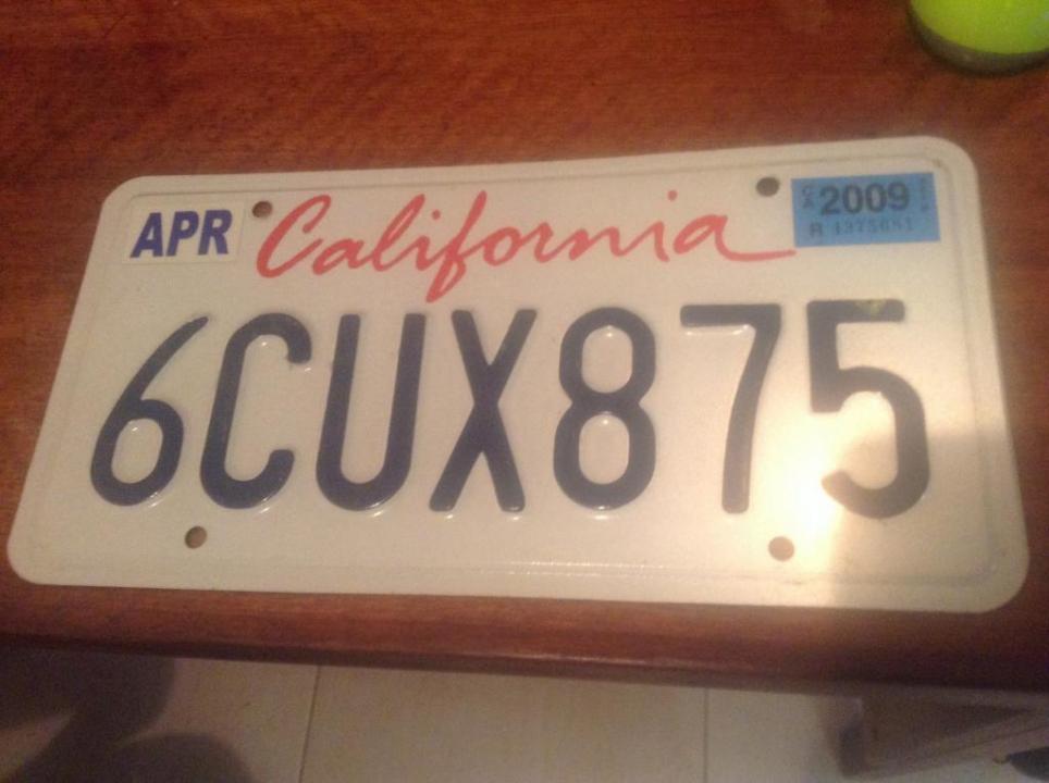

                            Since the car was from U.S originally and after some erase arch I believe actually came from California, I thought this would be a nice touch when I attend some shows and what not! Hehe
