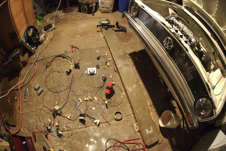

                Im now ready to wire in the megasquirt. Finishing the itb mani and radiator mods tomorrow if i can gee up my tig guy. Using an Audi v8 ruel rail and regulator. MS 2.2. new fuel pump. Ek civic radiator thats flipped on its side (too tall) and new outlets cause they were 28mm.
                got a new oil cooler and a volvo sandwich plate that has a temp controlled valve in it. Anyone have low oil press issues with a cooler? lines are really short.
                gave up on fitting the SSR reverse mesh rims even though they were super hot. got some 7x15 bbs rs style with a boring offset for free..at this point im more interested in getting it moving then rolling with dish. (sad huh!)

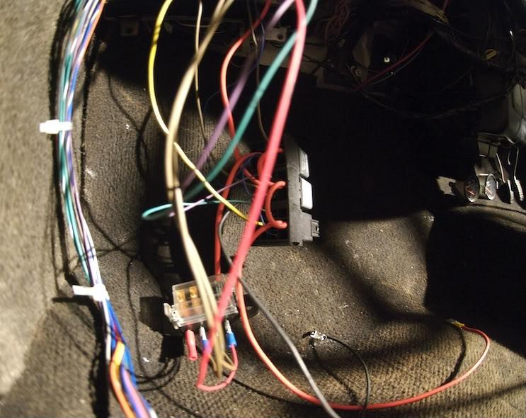

                          Got the cabin side of the MS sorted tonight, was pretty easy once you know what all the wires do..nice shady photo for reference.
                          worked out the general shape for the engine loom. routed all the wires bar the window wipers through the second port. i plan to use that nice mesh type stuff to house the wires.

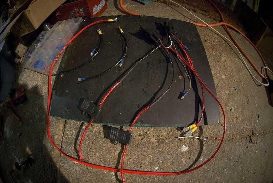

                          might go make a new headlight relay harness..old one seems a bit scrappy now.
                            bright lights are good. worth the whole hour it takes.
                              Great work - have a look at Techflex coatings. They make awesome wiring conduit in 10,000 different styles
