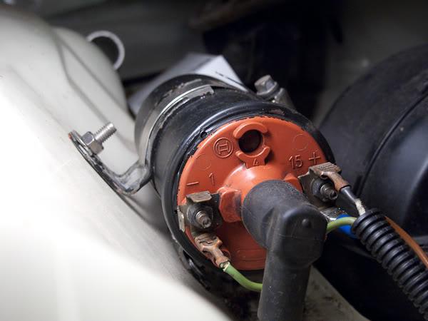

Hit the wreckers and got a volvo coil that has the 16v style plug. Bracket mod as its larger.

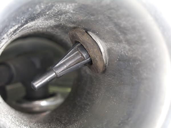

Toyota air temp sens

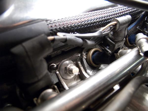

Mounted the 1.8t rail onto the mani and finished ALL the wiring.
Water temp sens fitted and throttle cable.

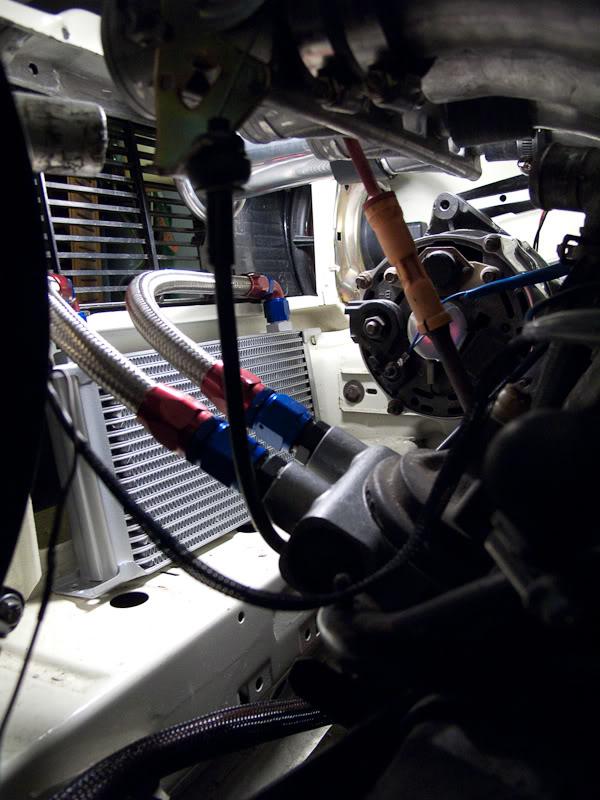

US Speedflow in -8, volvo sandwich plate with 90deg thermostat, china made cooler. Still to mount this as you can see. (I want more speedflow!)

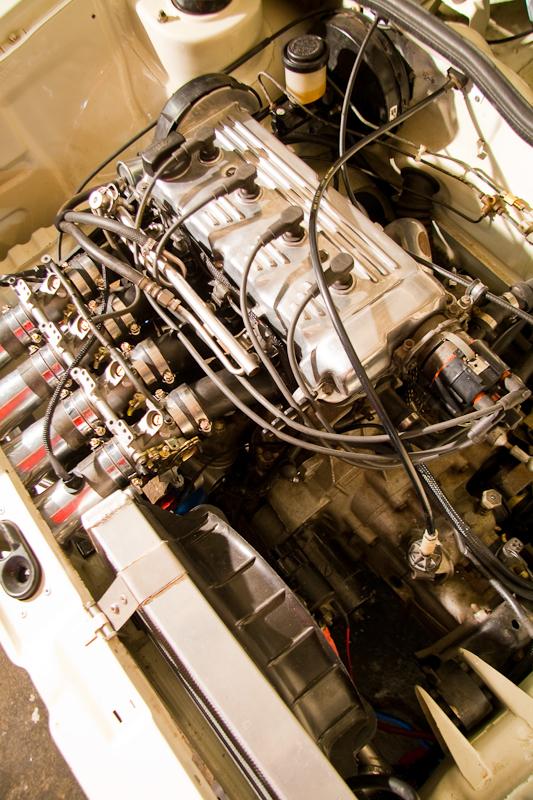

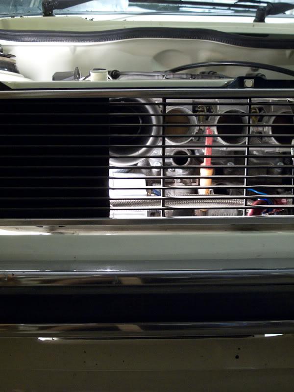

Just fits. Used 150mm trumpets, Puts the throttle plates a little outside the midpoint. Will have to block this grill off.

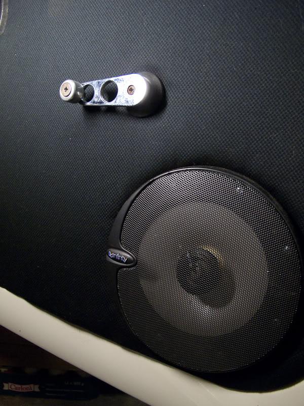

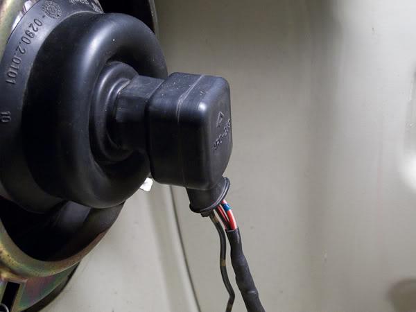

And the front cards, mini winders for 6.5' speakers.
