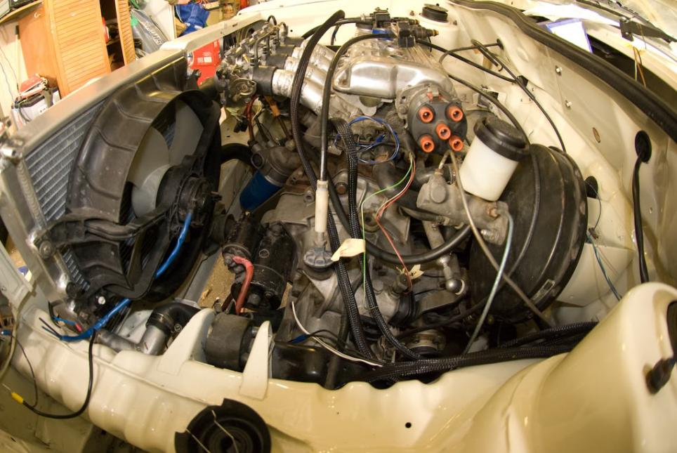

              A little..
              The loom exits out one hole and is covered with that snakelike covering and heatshrink on the ends.
              Rad an manifold are both complete..thanks to a generous friend with a tig. Its for a civic but turned 90deg and had new ports and the filler relocated.
              Found a pulsar brake reservoir at the wreckers. (thanks whoever tipped me off)
              switched to the better hall sensor in the dizzy.
              I had a shipment of parts from the states get lost in the mail and it had the remaining missing parts so im pretty bummed about that.
              Its so close its funny! esp as i go back to NYC next week for another 3 months so i guess its on ice till i return, parts in hand.

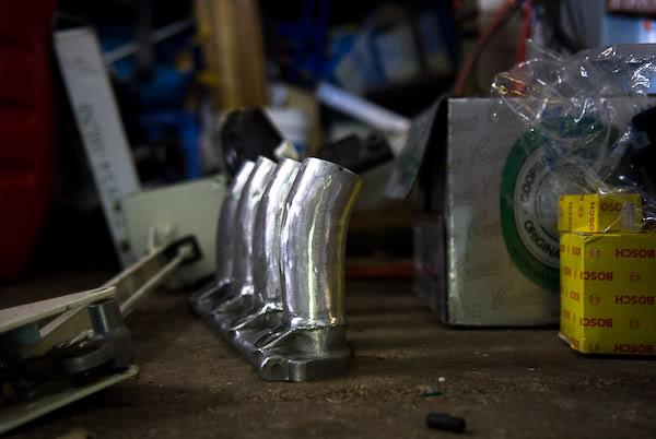

                          Also tidied up the inlet mani, after porting the inside the outside looked a little scrappy, just need to hit the polishingwheel now.
