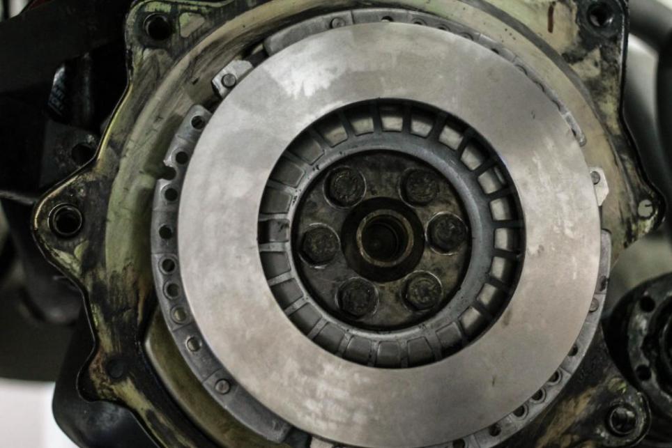

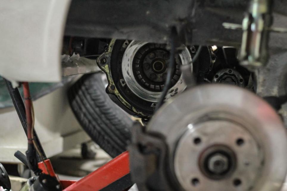

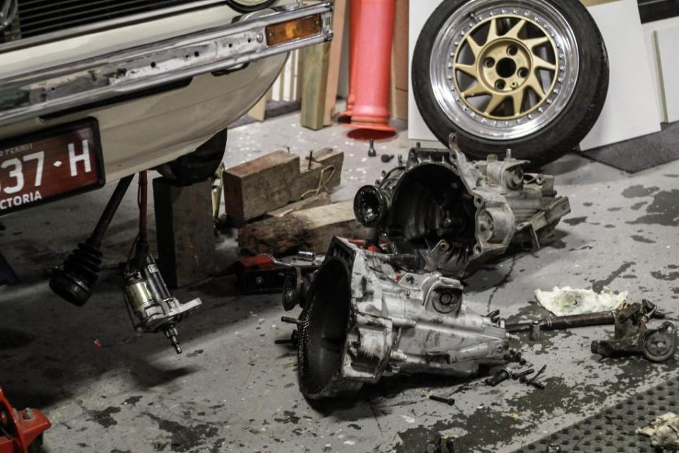

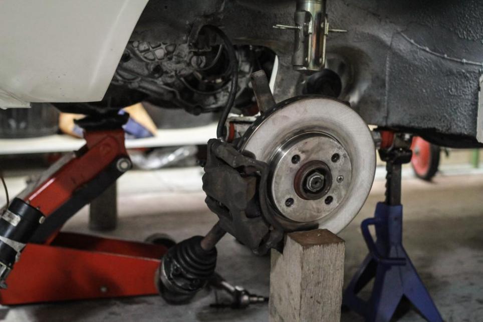

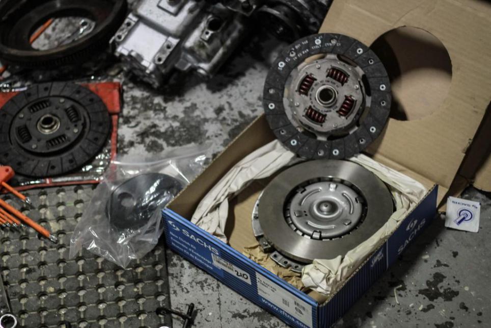

so, after quite a hassle, i have changed the clutch.

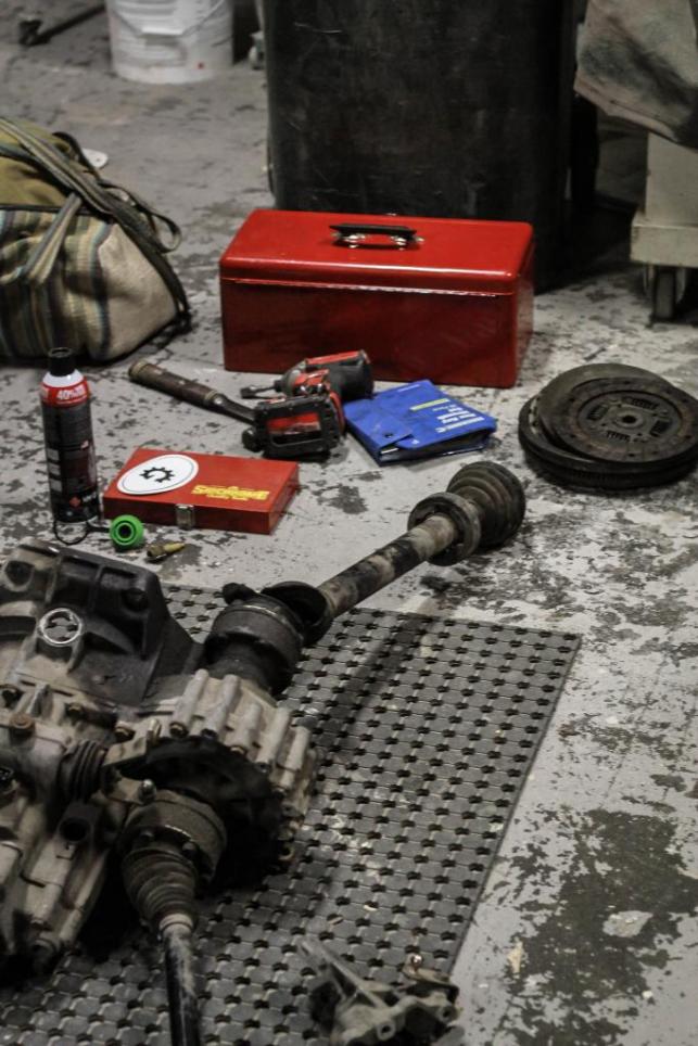

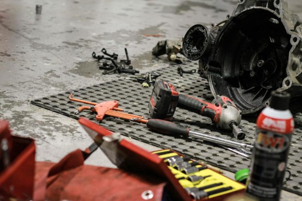

long story short, got a 210mm clutch/flywheel/pressure plate of james on friday, picked up a 5 speed out of a SEAT (thanks woody) and set about swapping it over (by myself)
managed to swap the boxes over but turns out the 210mm clutch I had picked up was a small spline and didn't fit the box, so swung past frenchy's and grabbed a brand new 210mm clutch kit (presumably to suit his 16v mk2) it was the larger spline and fitted up perfect.
now i blame woody for the next bit, as he assured me the SEAT 5sp had 90mm flanges. I found out it didnt when i went to bolt up the driveshafts.
anyway, came back the next evening and put the 4 speed back in with the clutch i'd gotten off james and all is peachy.

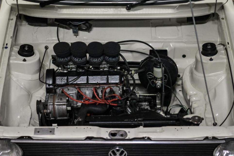

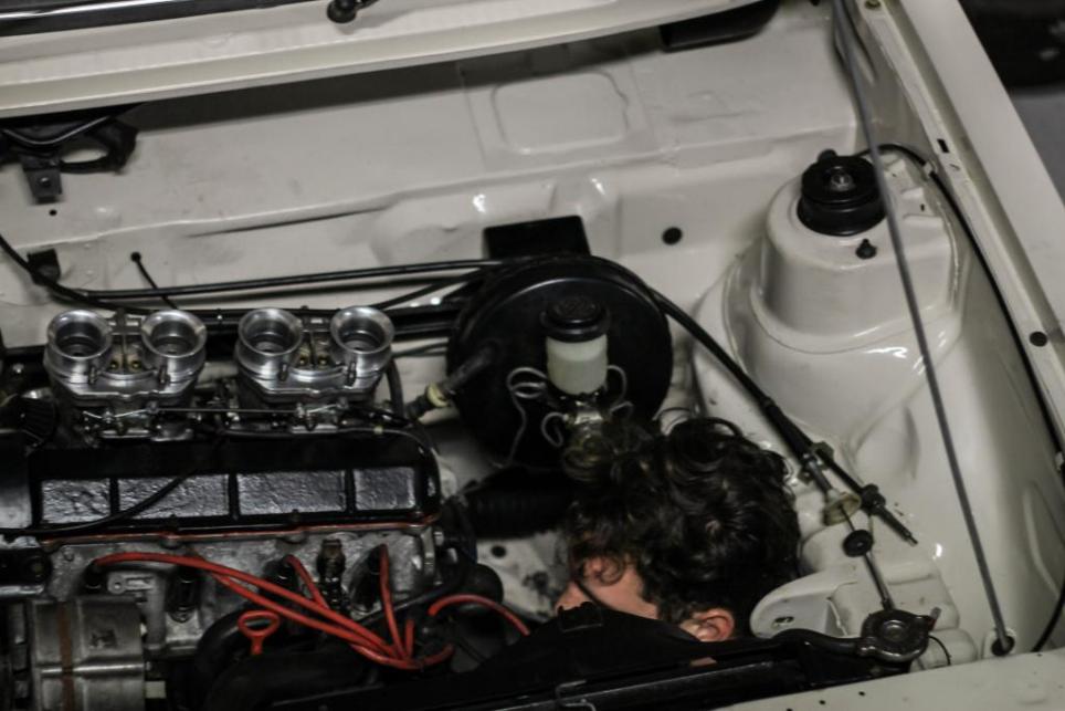

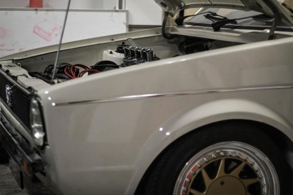

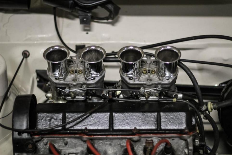

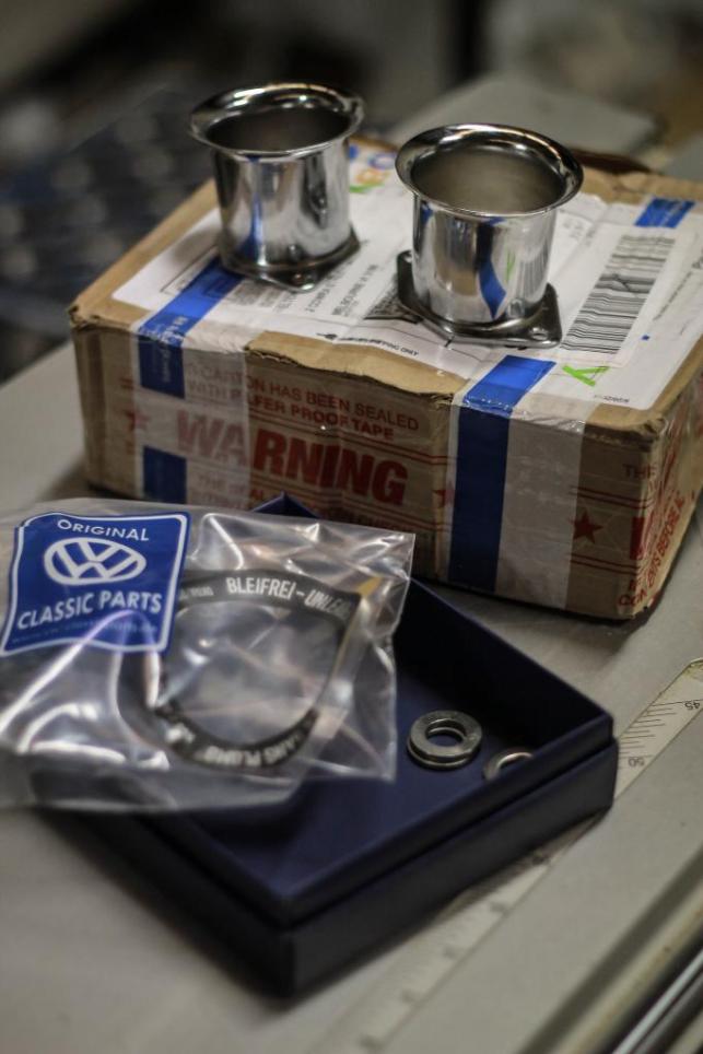

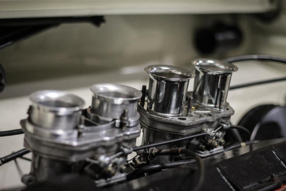

also got new trumpets and air filters and the car is in getting the carbs tuned, but despite that i dont think ill be making it to GAD
anyway, photos showing how everything played out

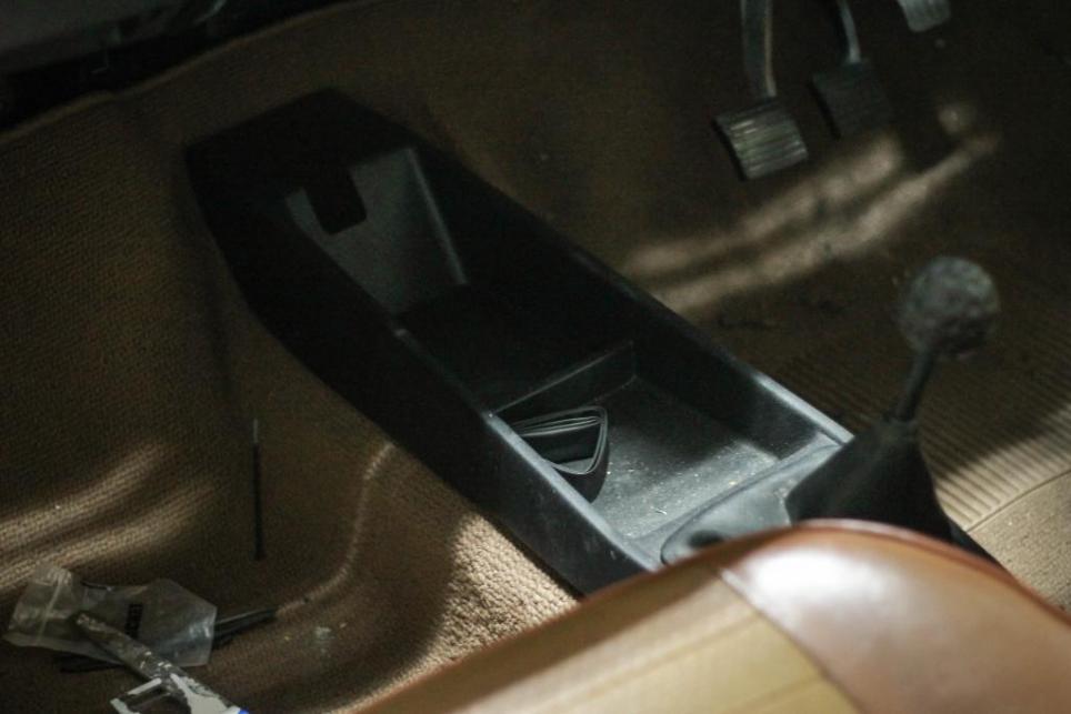

just finished welding up the bases for the porsche seats - should be in and recovered in time as well and then thats about it!
How/what exactly did you have to do to get the Porsche seats in - I have porsche seats with porsche subframes and also MK1 subframes ready to go - I just haven't really thought to much about how I was going to do it.Originally posted by eltonking View Postdefinitely.
