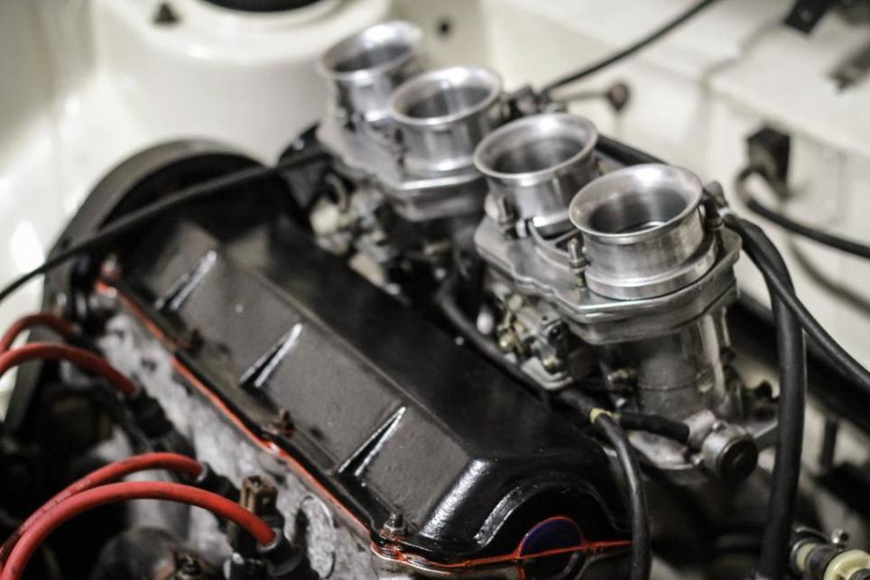

    Fitted up the choke cable and the carbs are running, need a tune but running. So giddy.

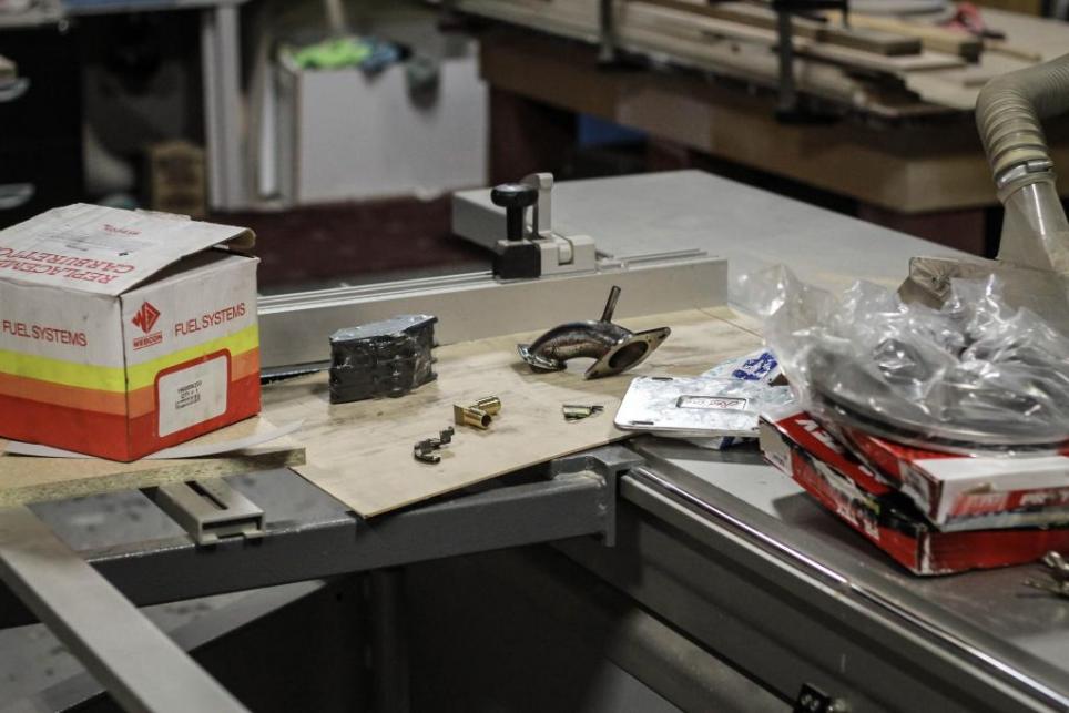

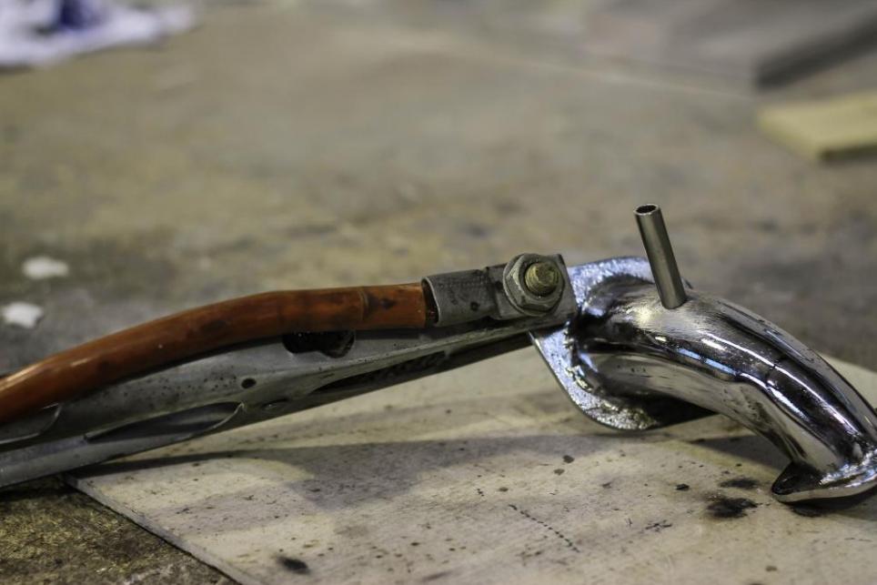

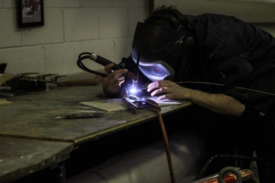

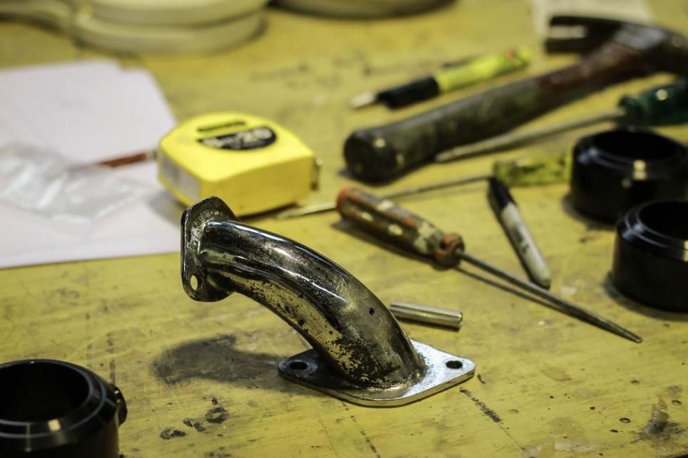

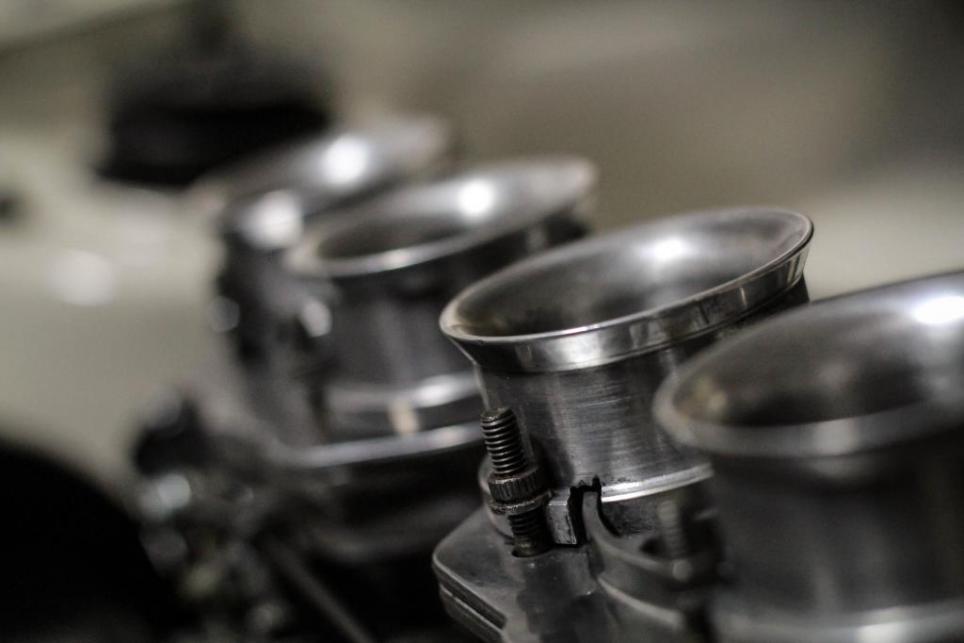

      After fitting up the twin carbs - twin weber IDF 40-42s (ouuffftt) I realised I didn't have a bung off the intake manifold to run vac for the booster, so got stuck into that with Frenchy

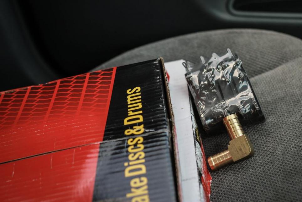

      Finally got the correct pads as the last ones I picked up last week were incorrect and new rotors to accompany them
      Also managed to fit up the choke cable, finish off the carpet and ordered new trumpets and air filters to boot.
