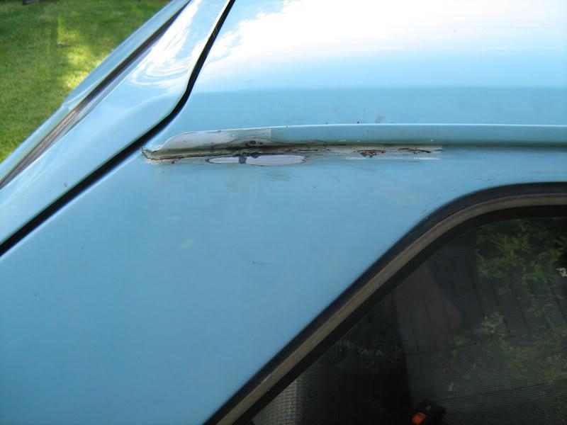

The rust in the gutter is only superficial just cleaned it up then. Will post soem pics later.76 MkI 3 door - daily drive/project - 1.8 5speed

Cleaned up the gutter rust, was just a bubble with one tiny little hole so happy about that.

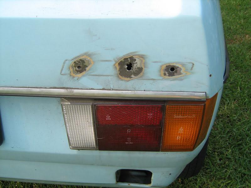

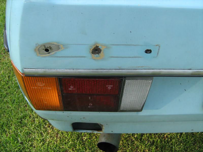

Also debadged the boot and cleaned up some of the bubbles from around the holes. The boot has two coats of paint so looks like it has been resprayed before.

Originally posted by Golf Loon View PostNice progress Matt, lose that chrome strip on the boot toojust removed it and all the side strips tonight.
Question, all the little clips that hold the side strips on, are they worth keeping? don't think i'm going to put the strips back on but I have never seen any for sale.

You can actually get the little plastic clips from empi or someone, they are the same as beetle.
Worth fasteners also make an identical one.sigpic Camden GTI Performance. VW / AUDI Specialists
A tip for popping them out, get a thin nail, and the back end of a lumpy screw driver and tap out the little "pin" in the middle, and then use some pliers to pull off the other part of the clip, it's alot easier than trying to yank off the whole thing... bit of WD40 won't go astray either
If you're going to weld up the badge and side stripe hole, I'll have a bit of advice for that too (cause I did it recently!)
