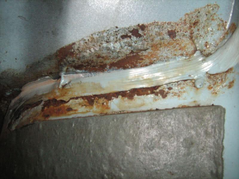

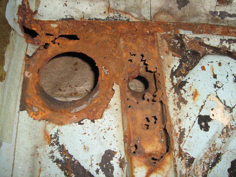

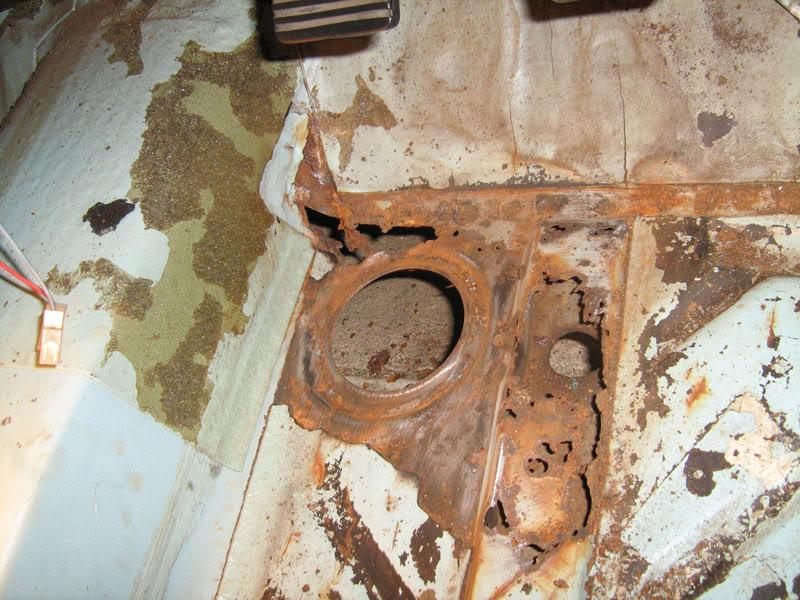

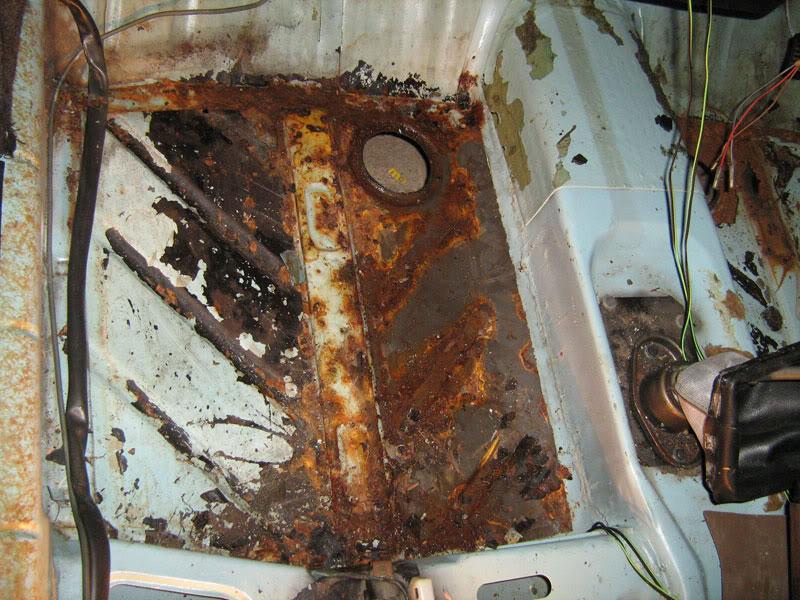

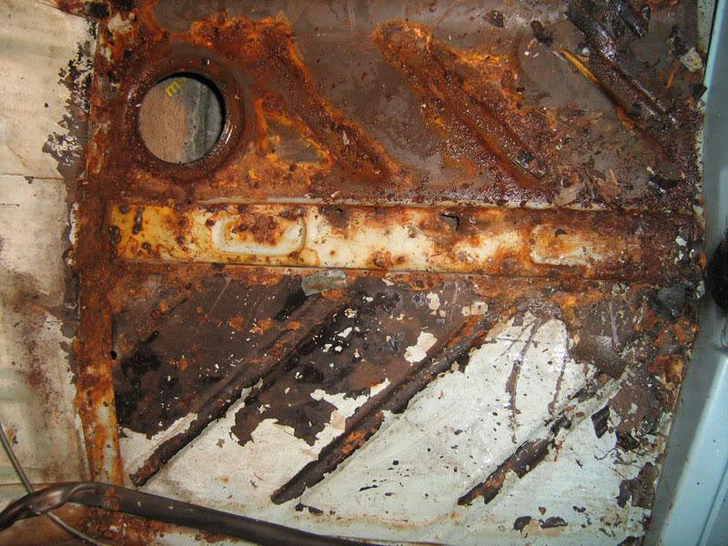

    Rust on the passenger side
    Drivers side going to have to weld in a section of floor from a donor car for sure.

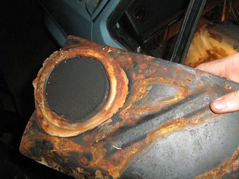

    You can see where water has come through the sealer and rusted
    The plug just pulled straight out with the mat, it was quite strange that one just pulled straight out intact.

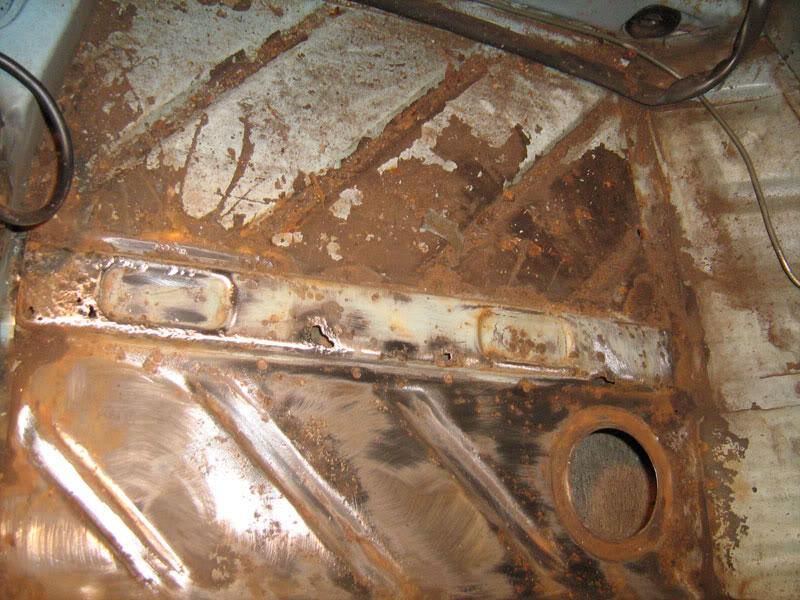

    Roughly cleaned up some of the passenger side area.
    Not the best of days with this discovery, but tell you what am i glad i pulled it all up to have a good look. Borrowing a good heat gun from my old man tomorrow and will pull up all these rubber mats.

      Thats not so bad mate. Someone who can weld can plate that with fresh steel. i wouldnt cut one out of a donor car they are all 30 years old.
      • #48
        Lucky i can weld than hey
        Will do some more cleaning and will see how much i need to cut out, if i can find a clean piece of original floor i would prefer it.
        • #49
          Might be tough to find good enough orig floor pans, unless you get them from a newer cabrio perhaps??
          I'd just pop in new metal, easier to work with cleaner and most importantly, rust free!
          Pity to hear about this tho! spose it's what happens with these babies..
          • #50
            Floor pan rust are very common in Mk1, it took me 3 months to clean everything up. Anyway, good find
            How are you going to strip it to bare metal ? I still haven't decide if I'd do that.

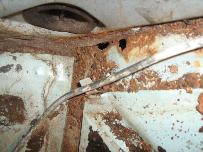

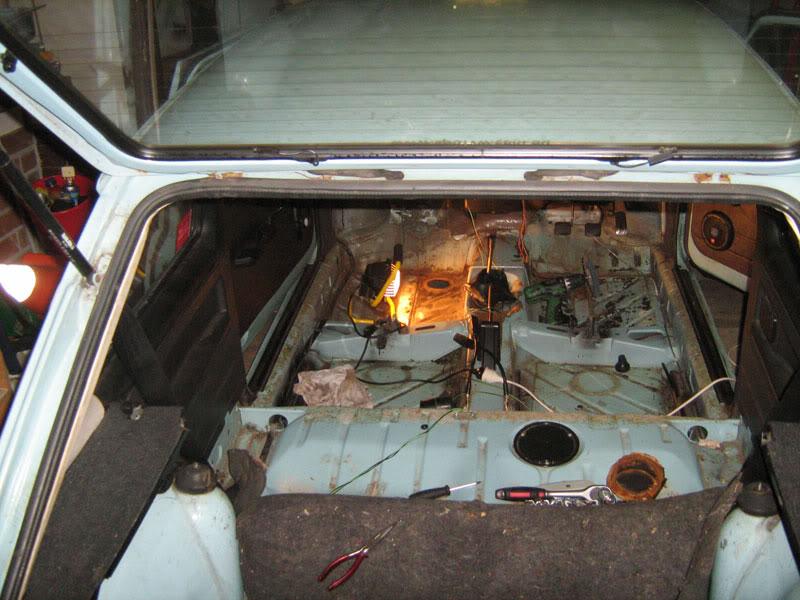

                                Finally got all the rubbery matting off the floors, it was all through the boot to ARGH!
                                Found some more rust along the way, all the seems where the wheel wells meet the firewall are rusted, oly one small spot on the passenger side is right through, the rest seems to only be on the one layer of metal. Atleast the boot and sparewheel well are rust free
                                Reckon im going to run without a backseat and maybe look at a half cage while im at it it has two doors for two people haha
