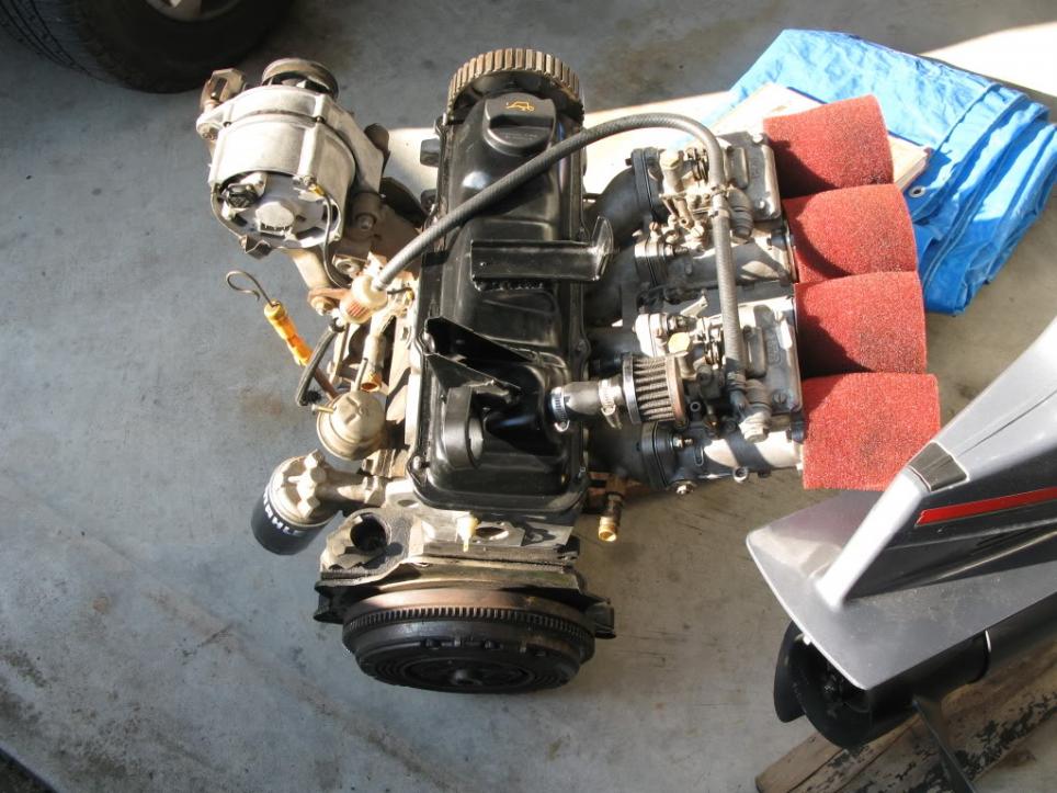

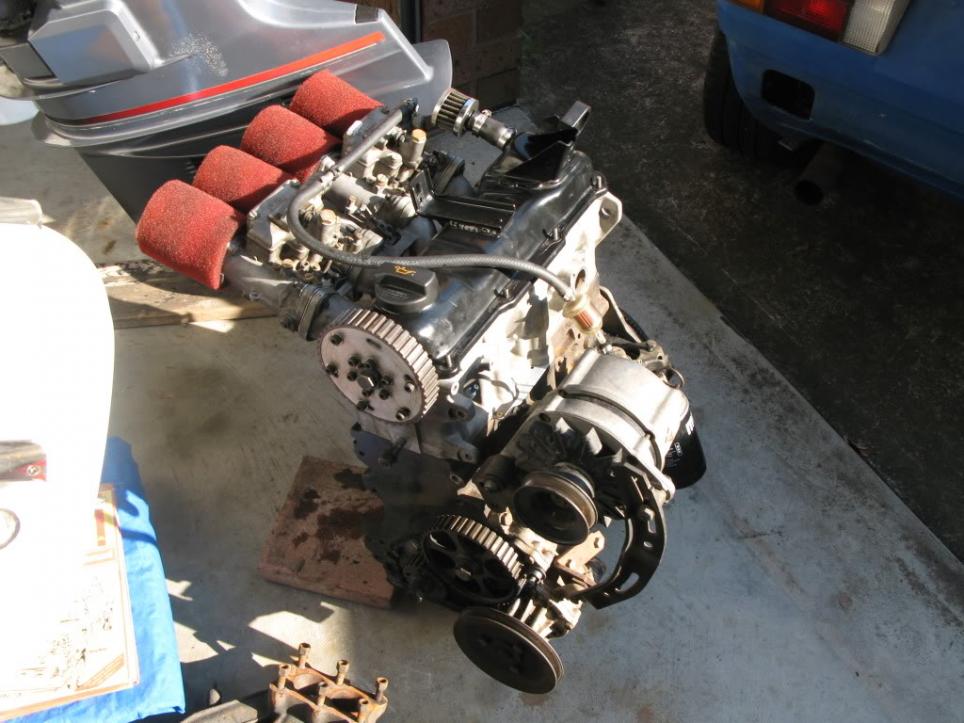

so the top end is all done, still have to tidy up the bottom end...i want to give the block a clean and a paint as best i can...also considering getting a new water pump as it looks pretty well used?...
one of the threads in the gearbox holes is shot and the bolt doesn't bite so i will have to get it re-threaded...
bought new water pump today, thought it would be a simple swap...but the internal diameter of the original pulley wheel is much larger than the fitting on the new pump so the wheel/pully doesn't line up with the holes, nor do the bolts/washers...anybody got any ideas?
i will probably ring vw tomorrow and see if i get a later model one and see if it's any different....
