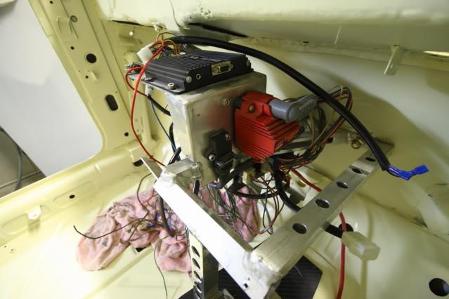

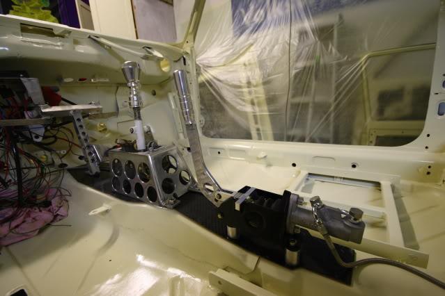

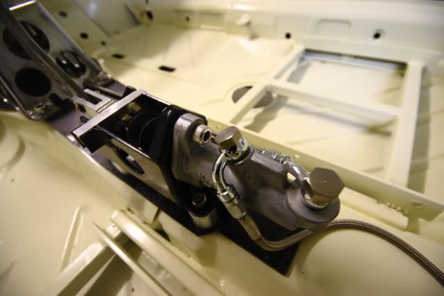

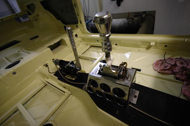

    • shifter and handbrake cleaned up , mounted the brains.

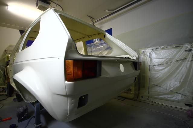

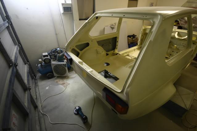

                    • Long story re the color , had decided years ago on Harvest Moon Beige , a beetle cabriolet color , as I loved how it reacted differently in different lights , sometimes almost white and others beige. Long story short , not available in acrylic , blah blah , them after looking over there color chart found Cream y34 and after a week or two of looking I think it super close if not better.
                      Yer will be leaving it for a good few more weeks before buffing , weathers not helping much.
                      Yer drop round whenever Ray.
                      Originally posted by Preen59
                      • Great work getting that BIG step out of the way! It's a great feeling
                        Re colour sanding and buffing: 72hrs is long enough, otherwise you won't get the best results. The paint needs to be soft (not that acrylic ever goes hard really) so you can cut into it easily and bring out the shine.
                        Did you put clear over a solid base (a fairly big no-no in most cases with single stage paint)? If so, make sure you sand through several of your clear coats (rather than just one or two), otherwise you're almost guaranteed that the paint will craze when it dries due to too much depth.
                        Look forward to seeing the results - especially of the roof, which is the worst part to blend from side to side
