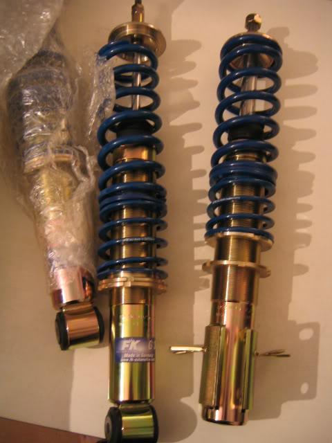

            i run fk out of germany via goingfast(german ebay store and year or two ago) they have been great ran them for a while with wide 13's so handling wise i cant tell you but height wise they go as low as you could possible want.they are the entry level as far as struts go and can be purchased with koni inserts and so on
            am very happy with my set
            cost wise from memory $850ish

                          i must say i'm impressed. out with the old hard as nails bilsteins and in with the more pliable technix (which look surprisingly exactly the same as the FK's pictured in alex's photo...) and the little LS is riding better than before, and a little lower.
