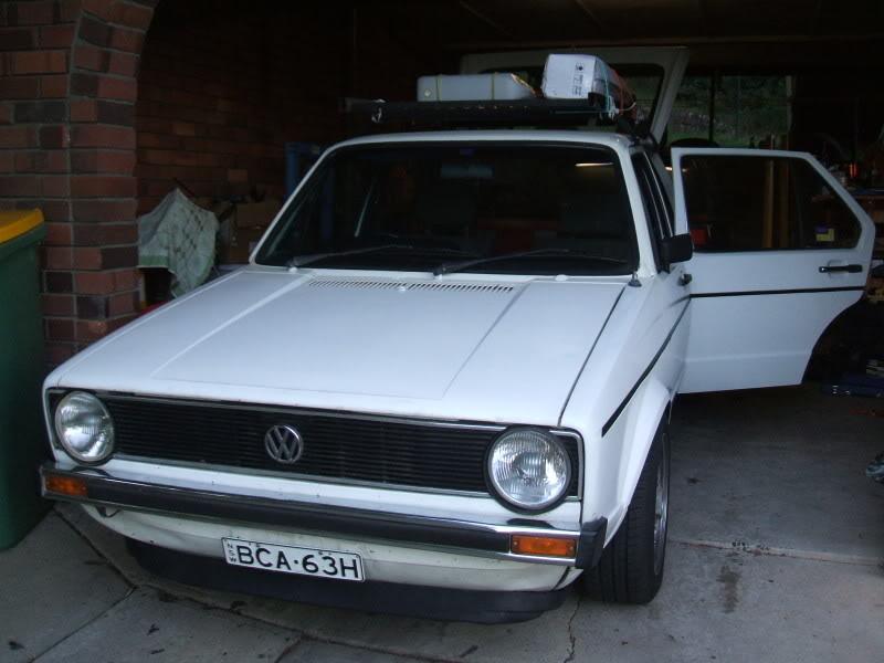

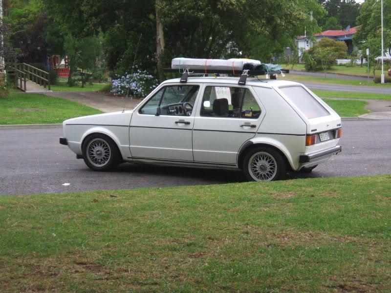

      i have to say they just keep surprising me. they have settled a little bit and the shocks seem to have loosened up a little, and the ride is quite comfy indeed. with a good load on, there was very little scrubbing (only over BIG bumps at high speed) and though the photo doesnt do my lowering justice (parked on a very cambered curbside) when static on level road the tyre was sitting just inside the arch at the back.

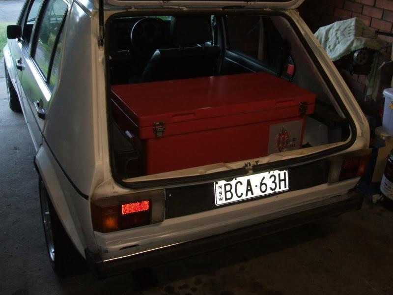

      my beer esky
      parked at the park in Bulahdelah
