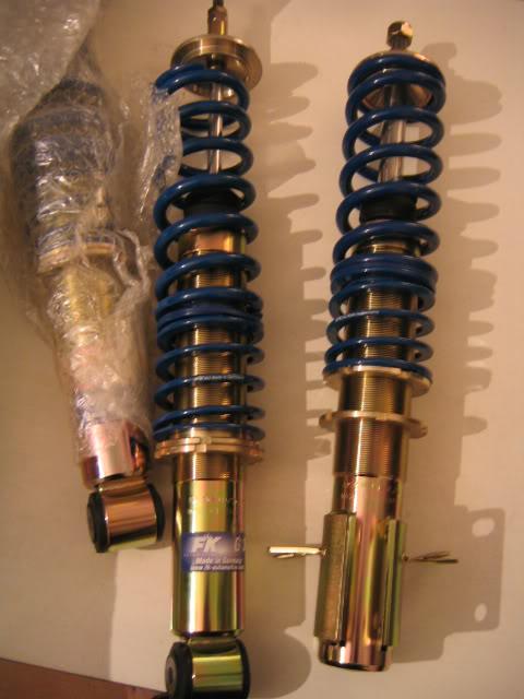

    i run fk out of germany via goingfast(german ebay store and year or two ago) they have been great ran them for a while with wide 13's so handling wise i cant tell you but height wise they go as low as you could possible want.they are the entry level as far as struts go and can be purchased with koni inserts and so on
    am very happy with my set
    cost wise from memory $850ish

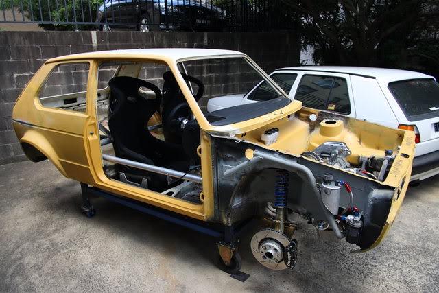

                    i have variant 3 KW for my race car golf mk1 project.
                    paid $2500
