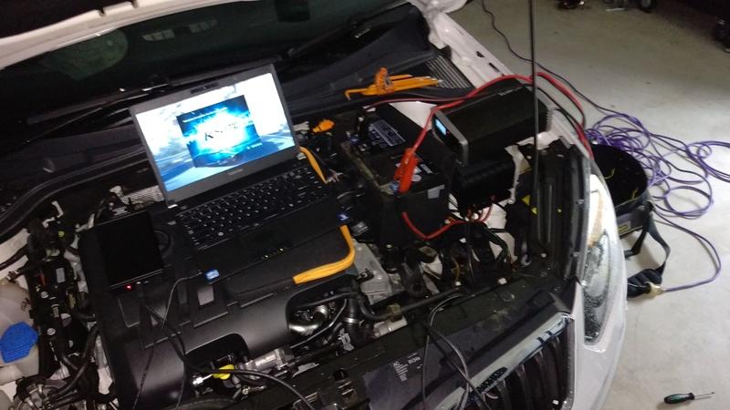

      Ok, but of an update. I've returned the Yeti ECU to stock in preparation for the dieselgate recall, and I've opened it up to take a full K-Tag reading of the stock ECU program. Once I get the new software "fix" applied, I will take another read, and see if the various programmers RDT use can work out exactly what the "fix" is.

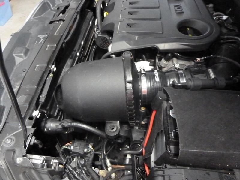

        OK Time to do some more tinkering, and I'm going for bang for buck. Here's the first mod, the intake.
        Ford BA GT Pod $30 off Gumtree
        Holley Dry Filter $55
        Silicon Adaptor $26.
        Sound gain - not bad, had hoped for more, need to seal it up to the over radiator inlet. Power gain, typically minimal, but it was really all about giving me space in the engine bay, and the feel good of a direct intake path. Off to make a suitable bracket now.
        EDIT: Oddly enough it has gotten louder after a few drives, not quite sure why, but it is much more like what I expected. Just needs proper mounting and the XR8 front snorkle.

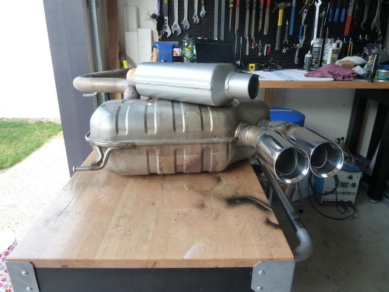

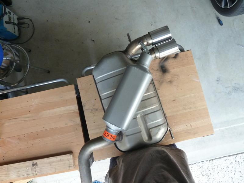

          Step 2. The rear muffler. Bought one of these HP-2 mufflers from Flowmaster, they look interesting. I'll put it in place of the rear muff, will make stuff all sound difference till I do some trickery with the DPF, and I'm getting over waiting for the dieselgate recall, so probably time to void that warranty.
          • #35
            Wow I forgot just how heavy the rear muffler is, that alone is reason enough to replace it. I bought the shortest 2.25" Flowmaster I could, and will just run one active tip, and one fake. Perhaps even swap to one big oval tip. Anway just need a front mandrel bend for the job, and a bit of 12mm tube to rig up the hangers. I also stuck my finger in the other end of the pipe, and got zero soot or dirt out, the inner pipe is clean as a whistle at 70,000kms.

                    ....which is indeed the plan, but I'm keeping a DPF of sorts, not really into being one of those cars you hate to follow.
                    My mandrel bend pipe showed up today for the exhaust fabrication, so it's MIG time.

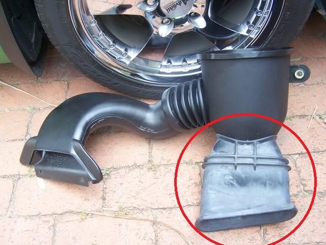

                    So did my GT / XR8 snorkle to finish off the intake. It's suprisingly big. Pic below is just an example, I don't have this side thingo going on.
