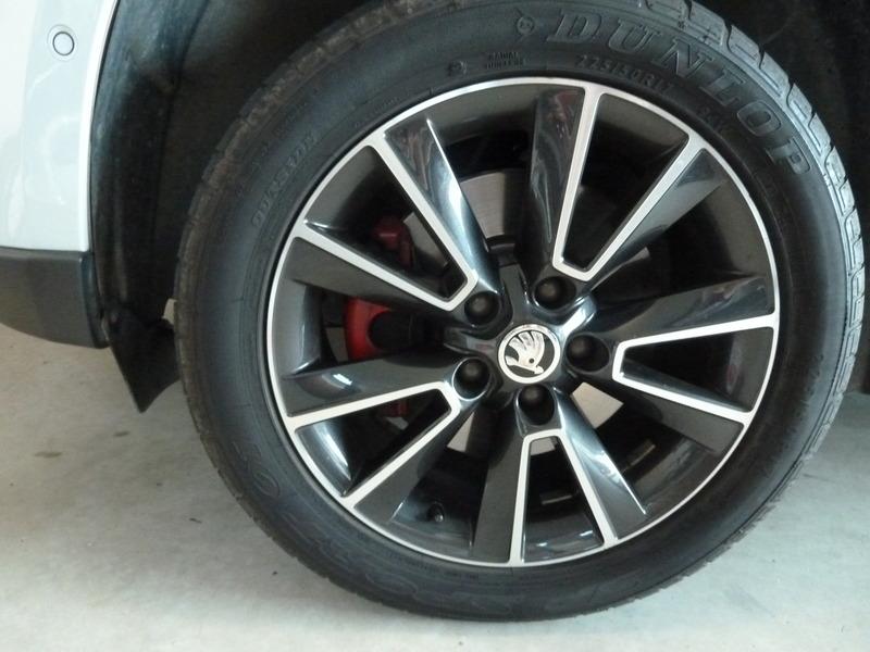

OK a long overdue update.
First to go was the stock Yeti front rotors, smaller than the GTI in a heavier car. In stock form the car would stop OK, but it never gave that sharp VW feel that the thing can really halt if need be. With the GTI rotors up front, it's a lot better, not aggressive, but there's a good stop in it now. Add to that the red calipers spice it up nicely, painted the GTI sized stock rears to match. Happy with that mod.

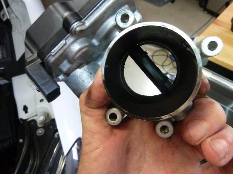

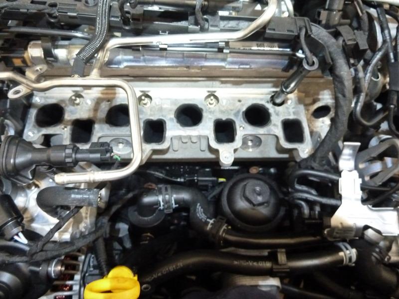

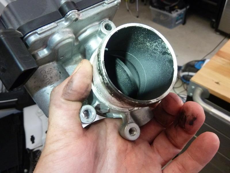

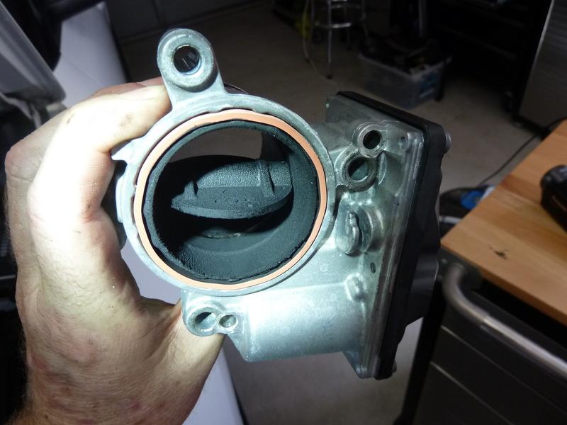

Anyway I decided to pull the inlet on the Yeti, both to see how dirty it was at 50 thou, and just to see how it has changed from the MKV. You sure have to remove more plumbing etc to get it off, but it's not a big job.
Big things I noticed:
Better flow design of EGR valve, no big inner reduction, about the same size.
Plastic EGR flap!!
Black inlet manifold has boost enter from below and then do a 180 and go down into head runners. Very different to the MKV with typical side ports. Odd change, but I guess there is reason to it.
No swirl / tumble flaps, at least in manifold.
All standard ring compression clamps as opposed to the MKV "C" clip / clamps which used to leak.
Provents have collected minimal oil, but first filter has had it, typical for the kms.
Inlet soot buildup was pretty minor.
Apart from the odd about face at the top of the manifold to go back down into the engine, it is a much better design. A Provent is still a very recommended idea, and at 50 thou my DPF is showing a quarter of the way through it's oil ash lifespan. Will it reach 200 thou, who knows, but then mine will be sitting on the shelf pretty soon, while I try out the sports DPF options. THAT is currently on hold till I see what VW do about the dieselgate situation, and what software changes they make, I want to measure them on a standard system.
