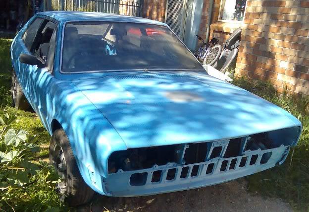

  • #31
    Link
    Glenn.
    Glenn....with Old Scirocco to replace old Beetle.sigpic

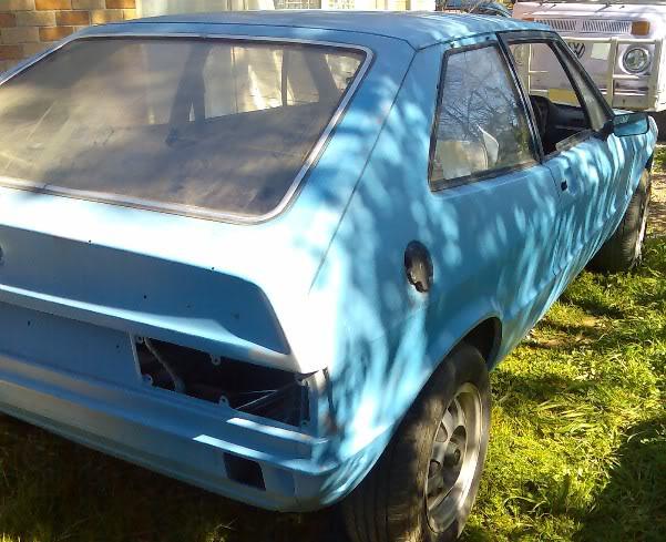

    • #32
      rear again
      Glenn.
      oh and Kombi behind
      and if you strain - you'll see Oval way back there.......

        thx for the pics Looks not too bad your Rocco!
        What are the next things on your to do list?
        Are you located in GB or in Oz?

            Yes tis New South Wales , as opposed to the " Wales " up north.
            Lots of Mk1's in Australia......ummm
            is 20 a lot ????
            - Does any body know how many are here?
            A wash down and pic in better light would make the Rocco
            look a whole lot better.
            As I said, there really isnt too much to do.
            Glenn.
