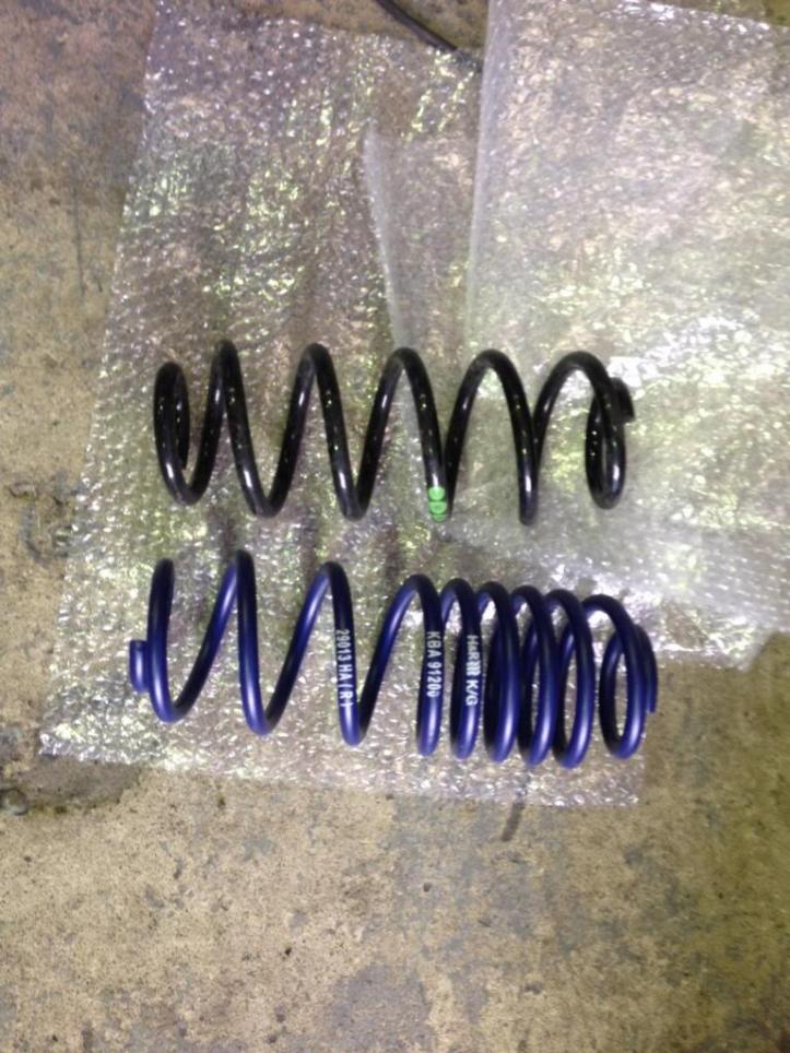

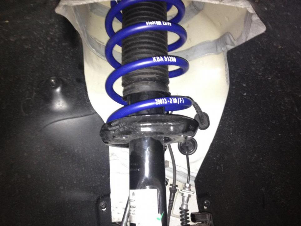

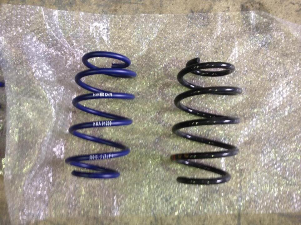

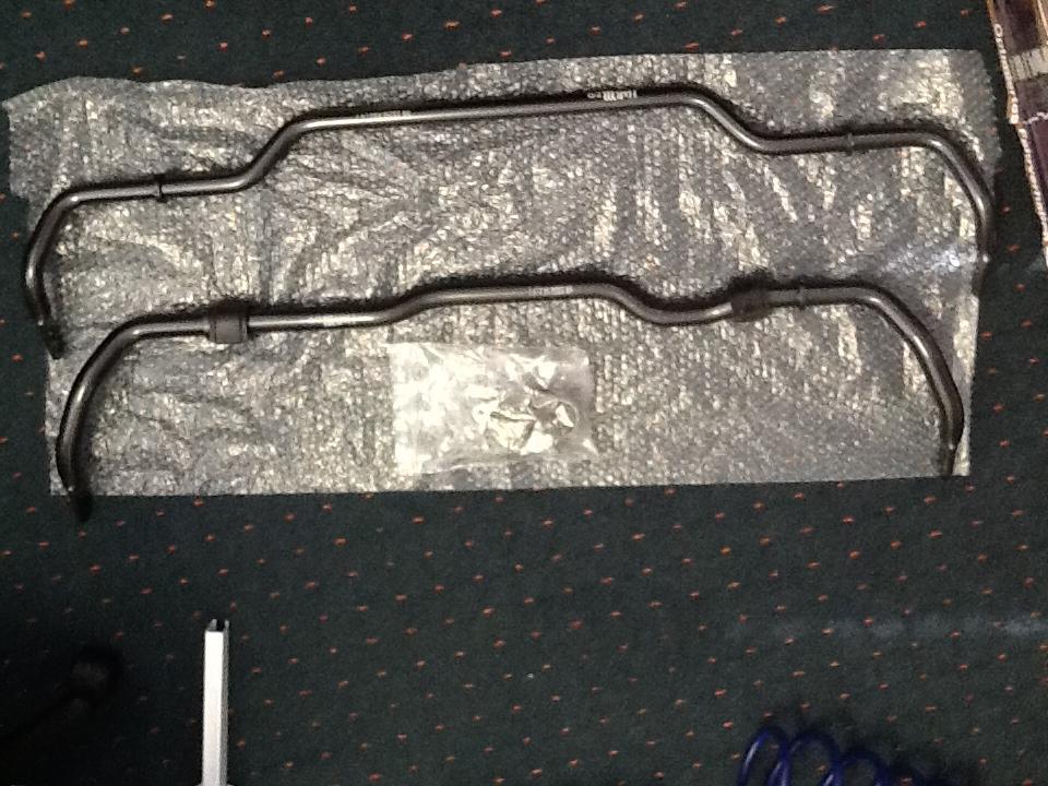

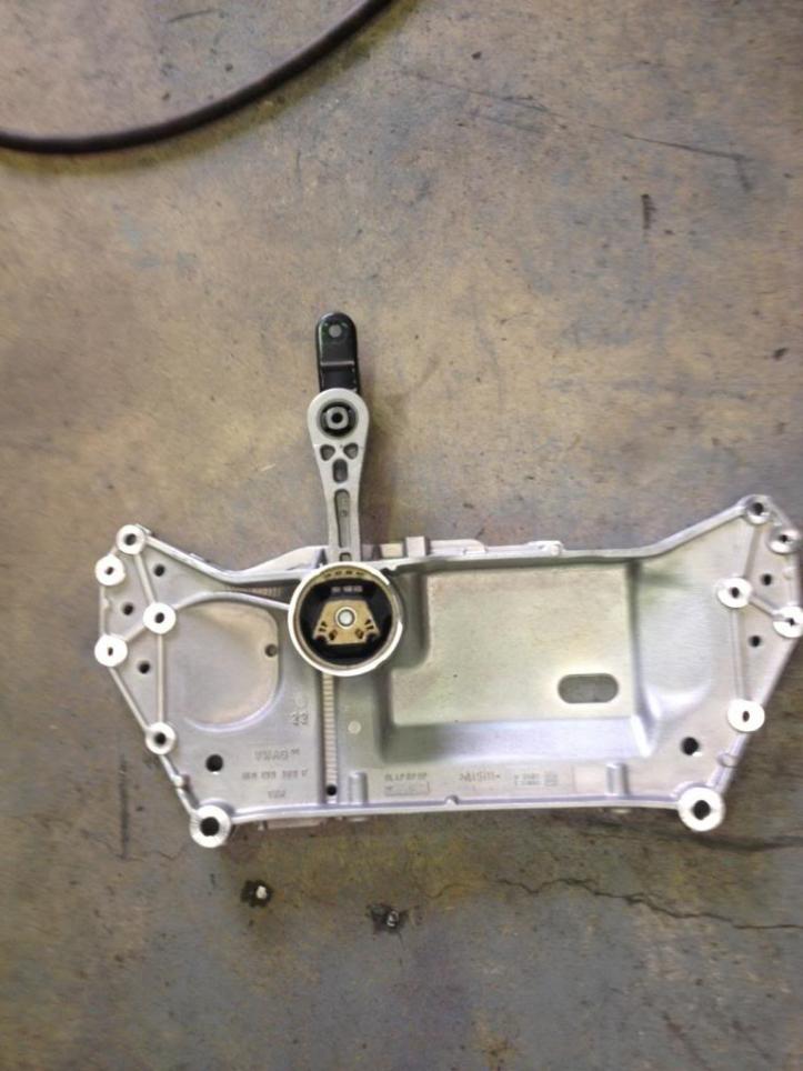

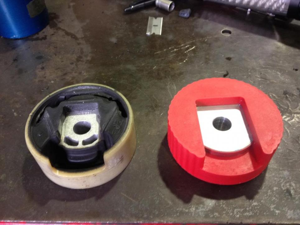

                        • Did some basic suspension upgrades today, had my mechanic taken some pictures for me
                          H&R springs
                          HPA mount
                          Thickest H&R sway bars 28mm/24mm soft setting
                          WALK
                          R Build Thread

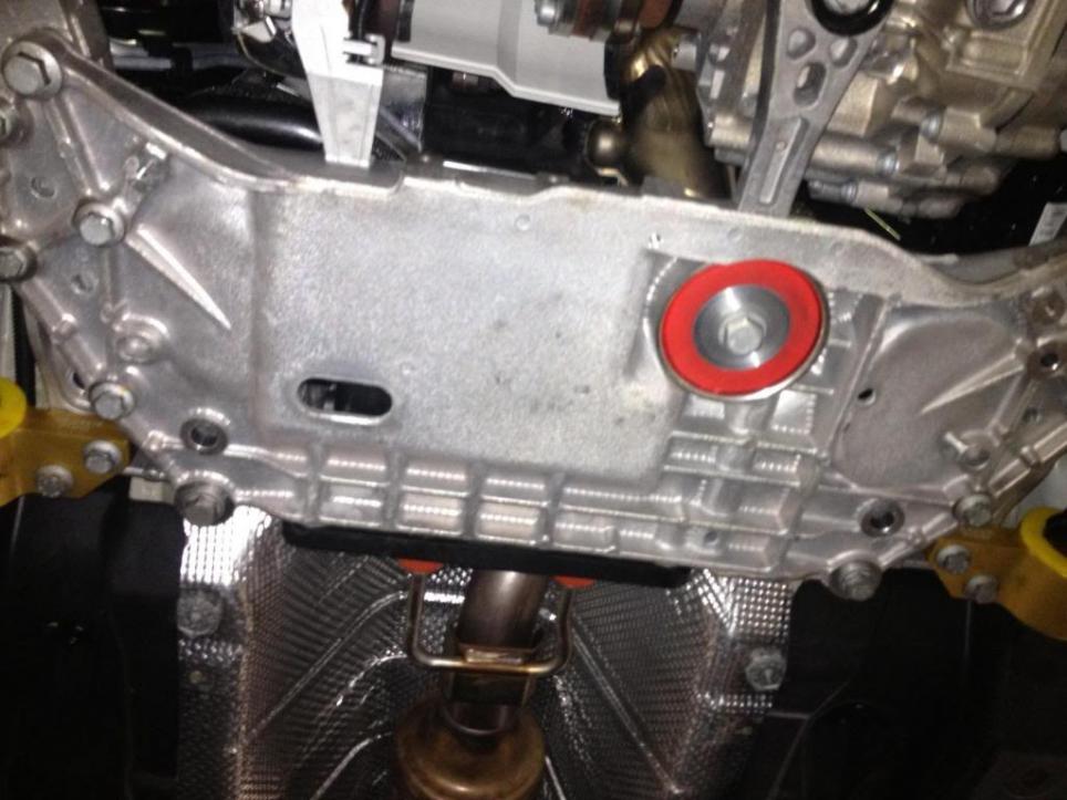

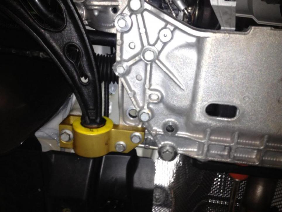

                          • What I did last weekend at home Just can't stop playing with it...
                            R Build Thread
                            • nice suspension mod pics!
                              What is the NVH like with the engine mount and Whiteline anti lift kit?
                              Manual MY12 RB Golf R | Bluefin Stg2 | Milltek turbo-back
                              • Just drove it for about 30km just now, I have a DSG, so the first feeling is there are more vibrations and noise when it is idle on D, and at low rev, but as soon as the turbo kicks in, it is much better. So I have to leave at N when stop in front of traffic light so not sure where it comes from (with my very limited mechanical knowledge ), I suspect the mount hasn't been settled.
                                The NVH probably won't change much for WAIK.
                                I just love the cornering grip it added along with sway bars, and can feel that the body roll is definitely reduced. Hmm, the other thing probably is a little more harsh on Normal mode. But not an issue for daily ride. Love it
                                I was trying to search around to see what other forum's comments after done similar/same upgrade.
